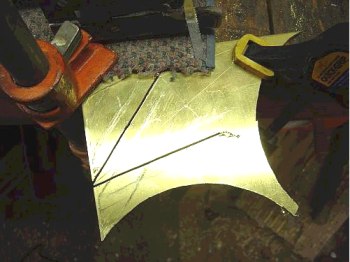

Layout.
Cutting and Fitting.

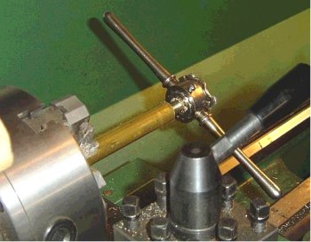

Turning, Threading, and Milling.
