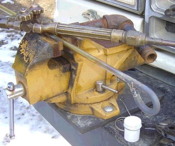

Lifting handle strap is heated and bent over a form…:
…the board end of the lifting handle is formed over a length of pipe and brazed…
…and the strap is installed in its mortises with epoxy and 16d copper rivets:
The handle will be cut to length and finished after the centerboard case is assembled….and the board is hung for the first coat of porch and deck enamel to be applied:
