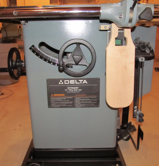

If you are successful in moving the switch to the left and don't electrocute yourself.......I'd like to do the same......left side is one of the few things preferable to the right side I can think of.......included a pic of my homemade safety paddle.......

Assuming there is enough cord length, I'll move the whole switch assembly to the left.  Otherwise, I'll cut up an extension cord to get a long enough cord length.  I'll probably mount it similarly to how you have yours.  I have the older style saw with the switch mounted on a 1/2" threaded pipe to the underside of the table.  There isn't a pipe thread on the left, so I'll either mount to the cabinet like you and build it forward for easier reach, or hang it on one of the fence bolt holes.  Because the hand wheel swings left, I have to leave enough space for cranking the hand wheel when at the 45 degree angle.

Joe......I'll post a pic of my shop made safety switch from the side and hope that it helps you in making a safety switch of your own......on my Uni there is a section of pipe that comes down to hold the power switch.......I attached a couple pieces of wood like a clamp on that pipe which gave me a platform to build on.......having a safety turn off is very desirable......just a bump of the knee turns the saw off.......

Great photo.  At least 1000 words worth.  Thanks.

Joe......there are two boards in the background that seem to be a part of the safety switch......just disregard them......sorry about that......
the two boards I placed around that pipe.......one in the back is just a straight board.......but, the one in front is shaped like a T......with the middle of that T extending forward and is drilled for a screw which allows the safety board to rotate/pivot.....

I've been meaning to do this for my same vintage Unisaw for a long time. Thanks for the picture, Roger. Now I may actually do it.
