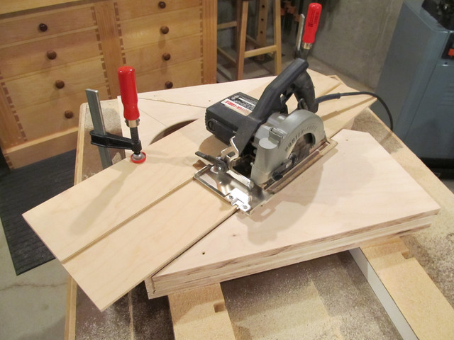

This is as close as I've ever come to a track saw.........
image upload
