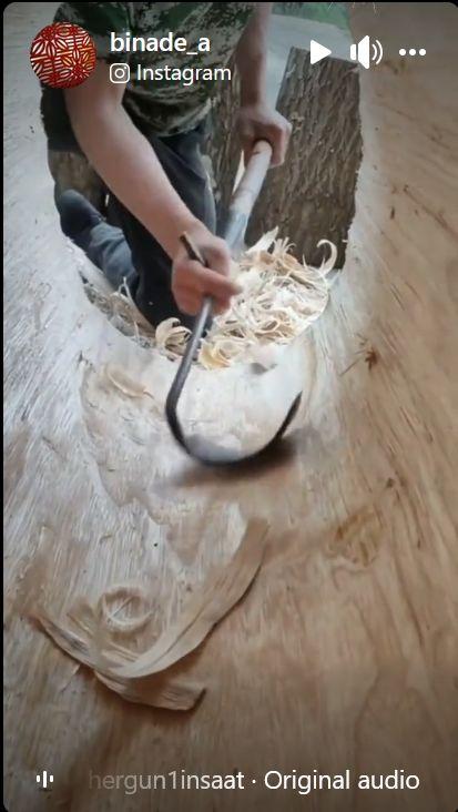

I suppose the original person who posted this question is long gone from this site, but I just saw this on a Facebook Reel, hollowing out sections of logs.
