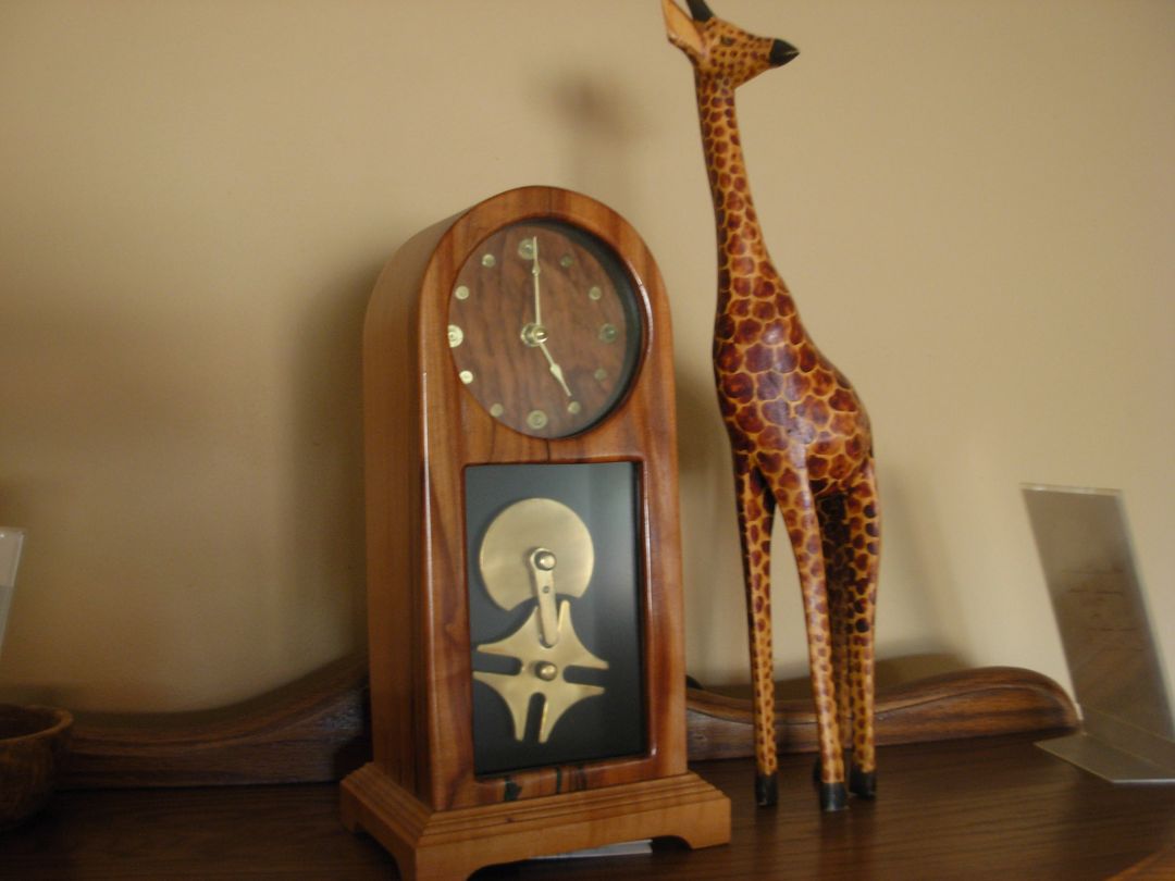

I brought back a  14" log of Madrone from Oak Harbor, Wa. cost me a whole $5. I made a tall clock with a Geneva Movement in the lower part. The 12,3, 6 and 9 o'clock are 38 special cases. The others are live 22 cases with the primers unfired.
