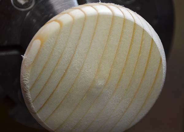

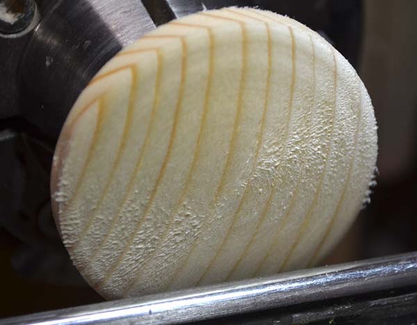

I was building a mock up for a new turning this morning. I was just using some crappy pine that really had a tendency to tearout. The first photo was done using a pull cut with my bowl gouge. The wings are much more acute than the tip and cut very cleanly on most woods. Especially when held with the handle very low so I had a steep sheer cut. As you can see it still left fuzzy tearout Easily sanded down on this wood but wanted to see how much cleaner my Mini Hercules would leave the surface. The bowl gouge had been sharpened earlier with not too many cuts done. The Mini Hercules has been used a lot for the past year with no cutter change. The bottom photo is doing a bevel rubbing push cut with the Mini Hercules. Much better.

Wow! John what a difference with your gouge being sharp and the hunter on a used sharpness

Wow, what a difference! I just got my 1st Hunter tools and need to make handles and try them out. I hope I can get results like yours.

That's an amazing contrast.
I don't understand it, but there's no disputing the proof of the pudding.

I've had similar experiences. That's the reason I was pushing, er, telling the club about using the small Hercules on the "small squarish dished platters" - I got cleaner cuts with some woods, even when cutting uphill on the wings to eliminate chipping on the edges of the wings.
It would be interesting to compare the same cut on wood like that with the large Hercules (or Osprey). I haven't don't a careful test but my impression is the smaller diameter cutter cuts cleaner, perhaps because it's taking a smaller bite each rev.

John that's a bit misleading. Using a pull cut with one tool and a push cut with the other means you are literally reversing tool travel. As flat workers know when grain starts to tear the easiest solution is to turn the wood around or move tool in opposite direction.
If you do the same test again with the tool travelling in the same direction and get the same result then it's the tool not the motion.

That's the difference between scraping and cutting. John refers to a pull cut with the gouge, but the gouge bevel is not rubbing - its a variation on a scrape. Joe

The tool was traveling the same way on both cuts. On the pull cut the bowl gouge handle was down and the wood was crossing the wing at less than 45 degress which has proven to be a very clean cut for me. The pull cut was done from the center out. The push cut done by the Hercules was also from the center out so for all practical purposes the wood was crossing the cutting tip at very near the same angle. The wings on my bowl gouge are ground fairly acute. It is a Thompson V gouge with swept back wings.

Yes the bevel is rubbing. The pull cut is done with the handle down and the bevel on the wood, flute pointing toward me. This is not a scrape by a long stretch of the imagination. A scraping cut on this wood would have been really really nasty.

Joe, maybe you are thinking of shear scraping which is different from shear cutting.

I'm not trying to mislead anyone. I try to make the cuts as close to similar as possible, more for my own information than than anything else. If a tool doesn't work I would tell you that also.

Thanks John for clearing that up. I think you will agree the important thing was each tool was travelling in the same direction.

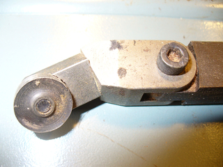

Should have been more clear. I have no trouble hollowing out boxes. It's bowls that I find a problem. I've got one that I think I SHOULD be able to set to get shavings but no matter how I set it I can't get a clean cut. Using brand new cutters I've tried adjusting the angle on the first link from straight through 90° and the angle on the cutting link from almost verticle to almost horizontal. I've got both a large one (picture) and a small one. No joy with either.
Maybe someone can tell me what I'm doing wrong. Or if this tool is hopeless, and what I sould try instead. I want to be able to get clean cuts while undercutting (sometimes pretty far) on a bowl. Here's a picture:
