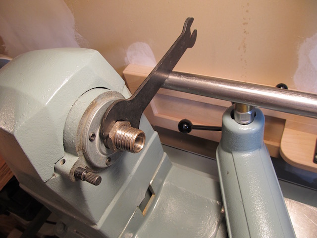

Only once in 32 years
Dick Coers

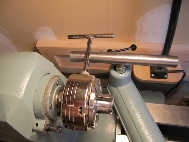

Did I want to lock the spindle from turning, when removing a chuck or faceplate was not involved. And that was to use the index pin to dovetail Shaker candle stand posts. The only other times I come close, is if I wanted to power sand something. But then I held it with one hand and sanded with the other. So you see my confusion about why you just want to randomly be able to lock the spindle.

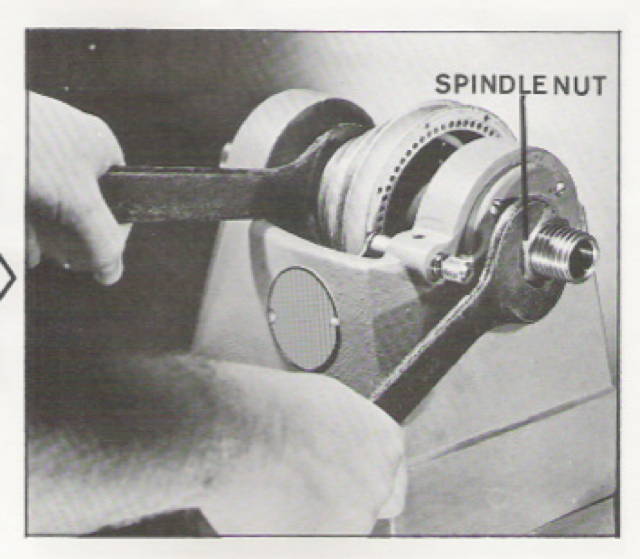

once every 32 hours
John K Jordan
I lock the spindle quite a bit, sometimes when carving, sometimes sanding. Since the PM will only lock in two places I use the pin in the indexing holes to position it close to where I want to carve. There is no significant force on it so the indexing is fine for this.
I lock every time, of course when removing chucks with the wrench. I've got the metal slide that holds the spindle lock button down that I use on occasion.

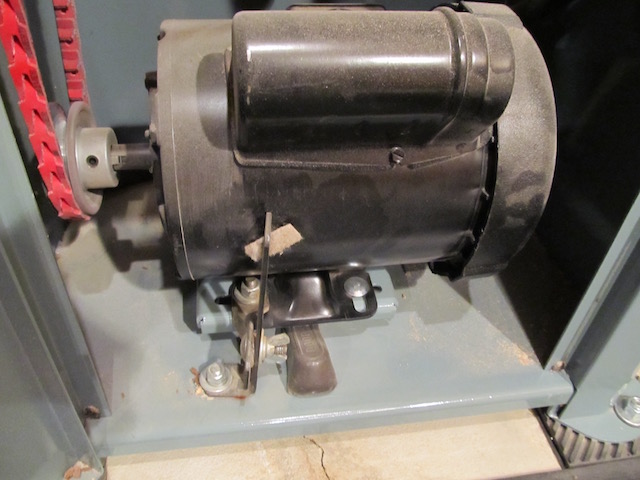

Steve Criscenzo

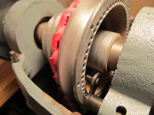

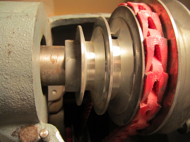

You may find the it will run quieter with a quality rubber belt rather than a link belt. My first lathe had a Reeves drive and ran much better with a solid belt. Downside is getting it installed.

roger lance
Steve.....if I remember correctly, I installed the link belt because it was said to run quieter/etc than a conventional solid belt.... :D
The install of a solid belt is not simple.....that's for sure.

Steve Criscenzo
Roger
My experience is that link belts work great with a solid pulley, especially a machined one. They did not work well on my reeves drive, likely due to the surface of the pulleys. I ended up going back to a high quality rubber belt and it made things run better.
Steve

The older reeves drives were made of better quality metals, many of the newer reeves drives
are made of cheaper "pot metals" which will not work well with link-belts. A quality rubber belt
shredding apart will often damage some of the cheaper reeves drives on the market today. That
has to be one of the weak links when working with reeves drive lathes. When one of the newer
reeves drives get sticky you need to be gentle with cleaning them and getting them working again.
Newbies will pry on the reeves pulleys with screwdrivers and pliers and usually breaker them on their
first rodeo.

roger lance

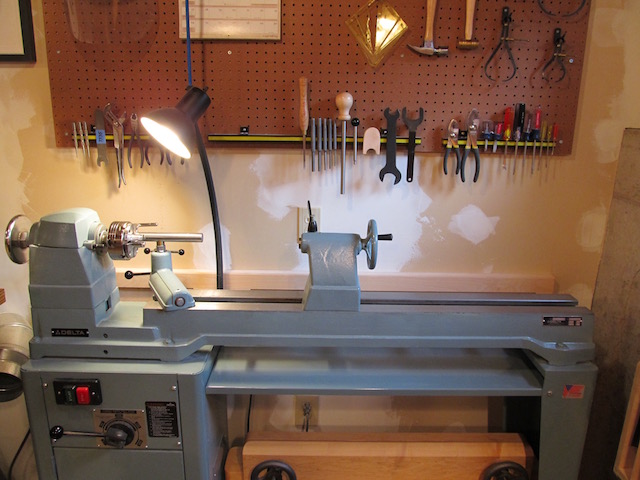

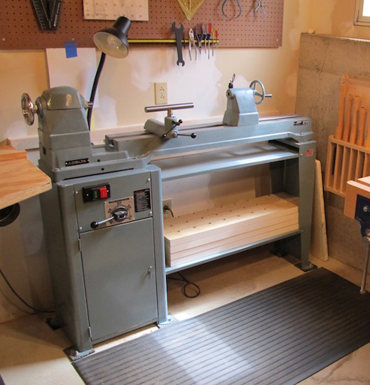

Knock on wood.....I've been running that link belt for a few years now.....no issues.....and the noise level is acceptable; but, thats after a lot of efforts to cut down the things that are rattling.
Which brings us to the metal cabinet. This may well be the largest contributor to noise generation on this old style of lathe. Motor vibrations get amplified in/by that cabinet. There is currently a lot of padding here, there, and most anywhere to cut the clatter.
