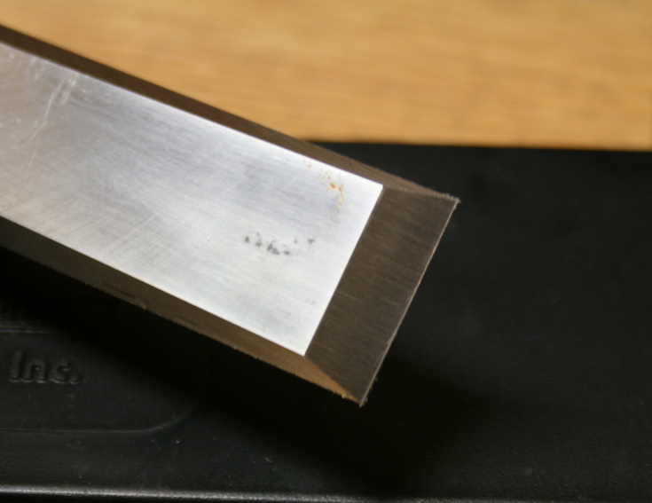

Eliot, evidently I did not explain myself clearly enough. I was not referring to sharpening, but using. A chisel with a small secondary bevel is more difficult to use bevel down. This relates to riding the bevel and then dropping it to cut. A secondary bevel can interfere here.
The action of sharpening a micro secondary bevel is about experience. It is not difficult to judge, say, 5 degrees after a period of practice. More difficult is re-sharpening at the exact angle, and some will need to restore the full primary bevel before doing so.
