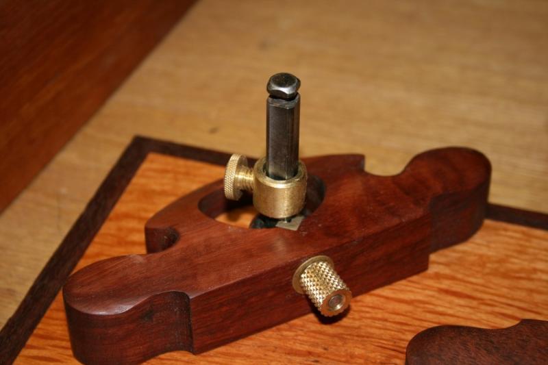

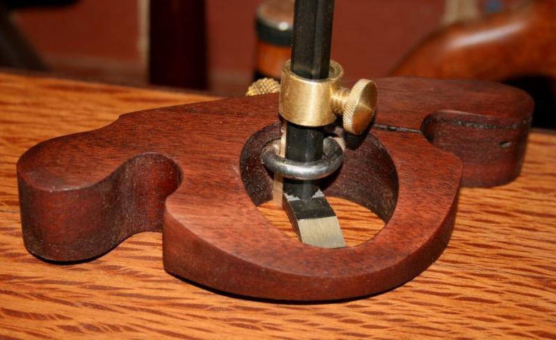

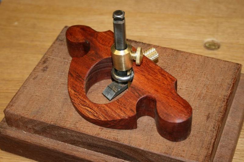

Joe, I have a few router planes. The Large from Veritas gets a lot of work, however I also made a small wooden one, and this gets as much use. The woodie does not have an adjuster, and is adjusted like a plane - with a tap of a hammer. What is more important than vertical adjustment is a depth stop. This allows one to set the final depth, and then you can creep up on it …
Note the use of Veritas blades. This creates a wide range of options …
There are plans available on my website (free):  http://www.inthewoodshop.com/ShopMadeTools/BuildingaWoodenRouterPlane.html
