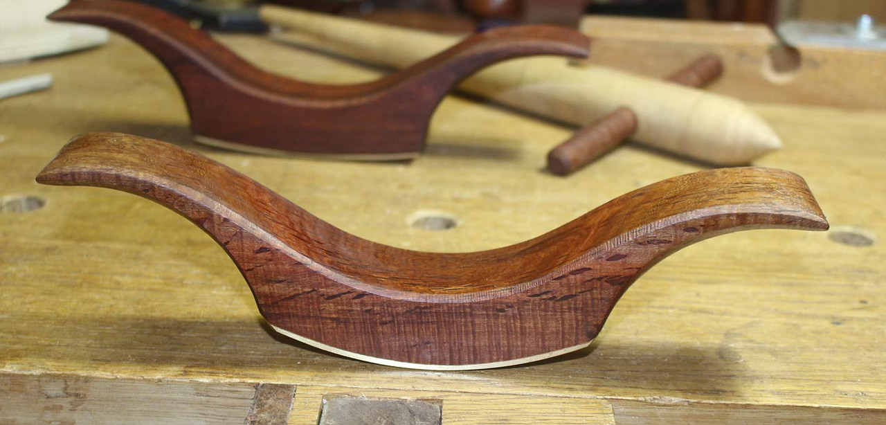

Possibly the most complex plane I have built was this bridle plough plane, based on one from Mathieson. Made in West Australian Sheoak and Jarrah ...
A much simpler construction was this router plane, which was designed around Veritas blades. Also a Causerina. This one was made for a WoodCentral auction ...

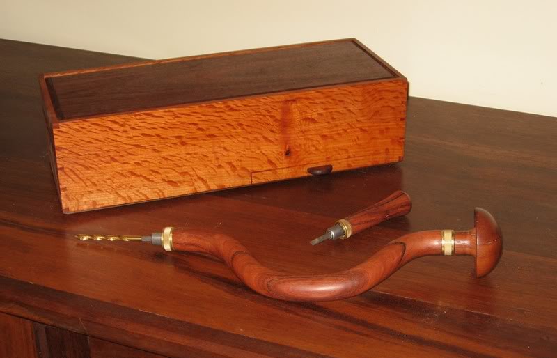

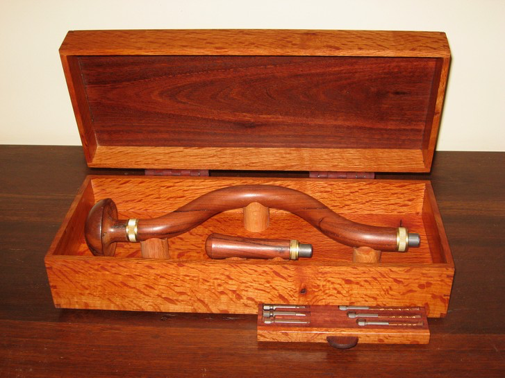

This was a brace (5" throw) built for a WC tool competition in 2008. It now lives with a good friend ...
I made another a year later for an Australian tool competition. This time it won a place (and Colen Clenton squares) ...

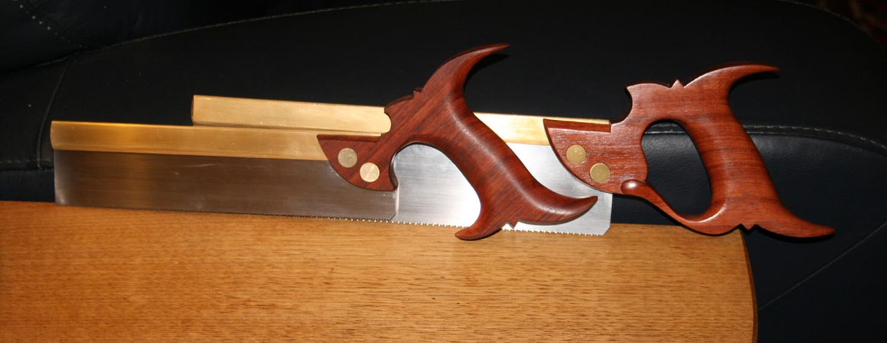

I've made many saws over the years ...
16" mitrebox saw (on a small MF) ...
Crosscut joinery saws: 9" and 14" ...
My favourite is this latest dovetail saw with a 0.15" thick (thin) plate and 16 tpi. It is now my favourite dovetail saw - a real light sabre ...
