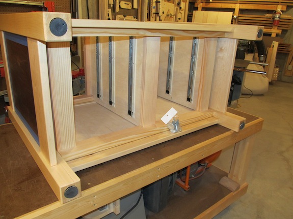

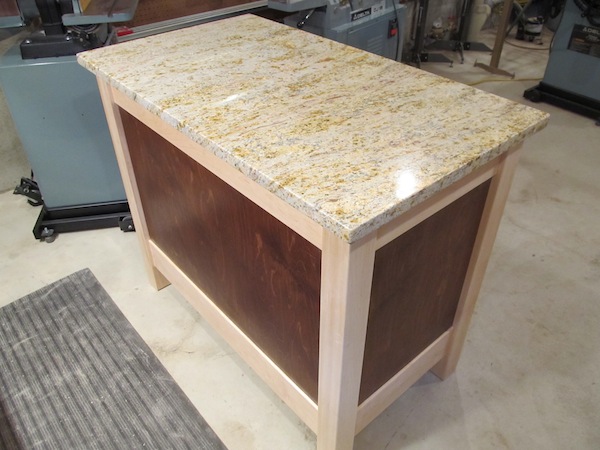

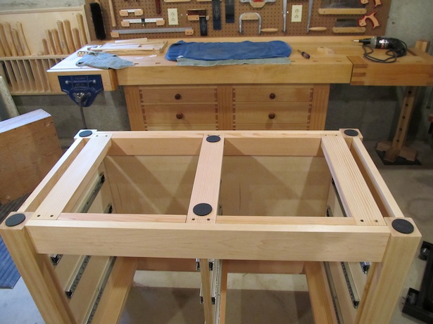

Well Pam and Moses, I did get a granite top....found a suitable remnant and was able to get the edge work done all around the top....it does make a beautiful top and water/mess is way less of a concern ( if you live in an area where you can get granite inexpensively, you should take advantage of that....it costs up here)....
I made use of a new product from LV....item # 88K59.08....which are 2" rubber grip discs.....by placing them on the bottom of my leg levelers....
and under the granite itself....
these rubber pads do not allow movement....the table is "stuck" to the floor....and the granite can not be pushed around....and there is the added benefit of being able to remove the top if I should ever want to move the table as opposed to the top being glued down by silicone.....I will show the station one more time after I install the laundry tub....now where did I leave those plumping tools???

That is a beautiful piece of work, I'm sure generations will treasure it. I would caution against the distance bewteen the supports for the granite. Granite breaks very easily when laid flat, and if it were mine I would put another bumper between the center and outside. I assume the granite is lifted off the framework between the bumpers. I'm glad you got the granite, you will love it.

Moses....I agree....when I go to move the table into its designated spot, I'll put some more pads down and beef up the support.

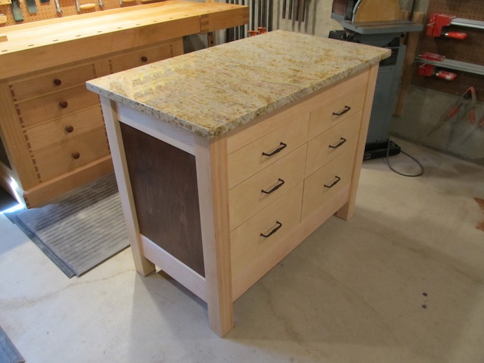

Bruce, a MN Galoot
but they should be darn proud being sharpened on a cabinet of that quality.
Really nice job, Roger!

That's really nice! And I like the use of granite for the top.
Did you consider routing a groove around the perimeter of the granite slap to help corral water that spills onto the granite top? Sort of like the channel that you might find in a carving board.

Wilbur....I didn't consider that....I just thought I'd use it for awhile and see how the water mess goes....have a towel on stand-by....also, I think that I'll be getting the Shapton Pro stones which only require a "spritz" of water to get started (so they claim)....no extended pre-soaking....I know you have mentioned using those stones, so how messy are they??....do you recommend them??

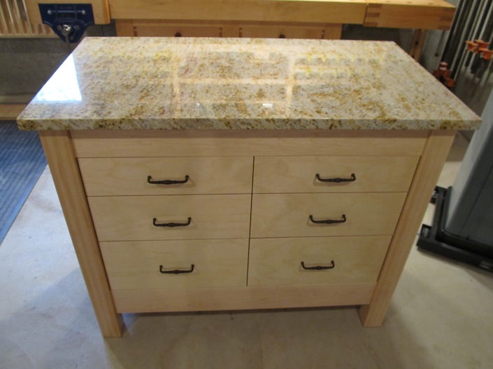

Roger, that is fabulous work. I'd say that it really would go better with my new bench than your old thing, but I don't wish to conflict you :)
Do you have running water in your shop? The Shaptons may not need to be soaked, but they still do need to be wet. Try and get hold of Harrelson Stanley's video on Side Sharpening in which he uses Shaptons (surprise!). I was amazed at the amount of water he uses. He was constantly pouring streams over them. He did contain all this in a trough, which you will need to do as well. My sharpening centre uses a kitchen trough (I have running water). My other recommendation is to add a little liquid detergent to the spritz bottle. This will lubricate the stones and prevent stiction. It also keep stones and hands clean.

Height?

Beautiful furniture, nice job on the construction.
The comment below is kind of late, and I'm sure you considered your sharpening method when designing your bench, but it seems awfully high for hand sharpening - especially if you do any freehand sharpening.
My sharpening bench (a piece of melamine nailed to the wall) is a tad lower than groin height so that I'm working right above the stones. I freehand sharpen almost exclusively.

36"....different strokes for different folks....see the discussion started on this forum on 2/8/12 entitled "Next project...a sharpening station"....the dimensions of the proposed station were given including a 36" height which was supported by a number of members here as a height that they were using in their sharpening....if it proves too high for me, I'll make some kind of platform to stand on....been hitting the little white ball yet this year??
