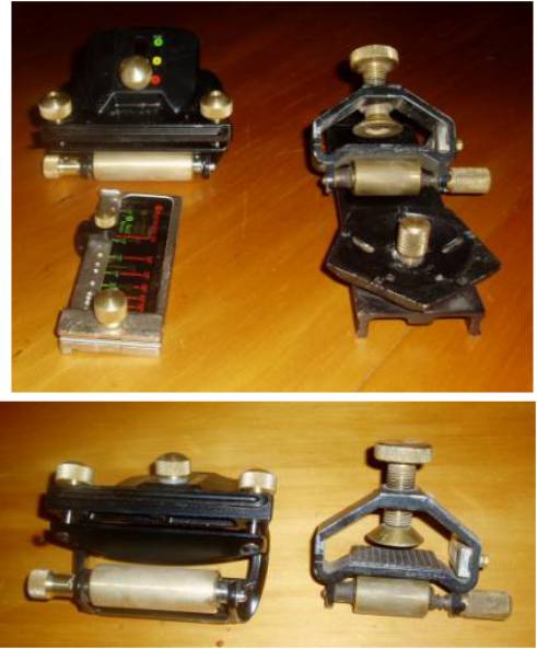

>Saturday May 21st was a bit of a first for Perth when local Galoots congregated for a sharpening workshop, and were able to see and use the new Veritas Honing Guide Mk II. There were a number of excellent presentations, both of technique and jigs, but center stage was definitely held by the Veritas guide which quickly received many positive comments.
The new guide (Mk II) not only overcomes all of the criticisms levied at Mk I (which was an excellent guide, nonetheless), but certainly now impresses as the best honing guide on the market at present.
Finish is in black anodized steel with brass fittings. As we have come to expect from all LV tools the quality was immaculate and everything worked perfectly out of the box. (A little confession � in true Aussie male style I did not read the instructions that came with the guide. The fact is this guide is so logical that it does not take more than intuition to work it out).
In use the Mk II felt solid and smooth, much more so than Mk I. Conversely, in spite of the wide wheel, it was still possible to add pressure to the blade ends to hone a fine radius (to feather shavings).
Several members of the workshop has the opportunity to try it out for themselves, and the unanimous decision by those present was that they would buy one as soon as it became available.
My thanks to Rob Lee and the staff at Lee Valley for the amazing efforts made to get this guide to me in time for the workshop, knowing that there had been late alterations to its machining, so delaying production. It arrived the night before, much to my great relief.
Details of the Mk II are in successive posts, below.

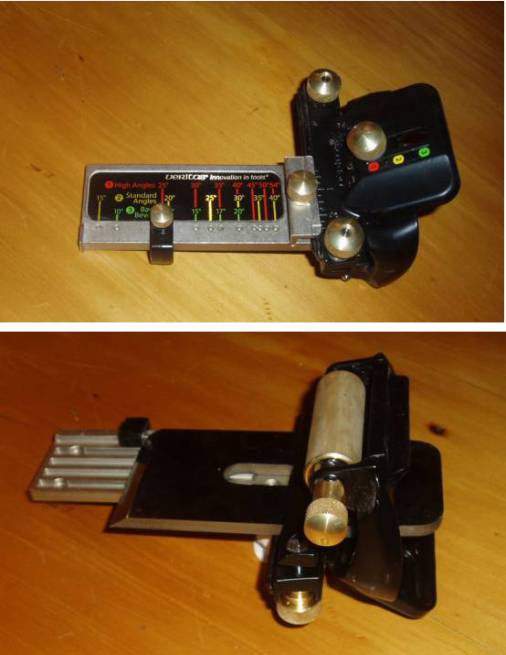

>Notable new features include:
- a wider track, ensuring greater stability
- ability to use wider blades (up to 3�or 75mm)
- a wide range of bevel angles, from 20� - 54�
- the ability to cater for both micro bevels (in 1� and 2� increments) as well as backbevels (10� - 20� range)

>Setting up the Mk II involves attaching the protractor. This slides on and is then positioned according to the width of the blade, which ensures that it is always centred. As seen in the picture below, there are separate scales for High and Standard blade settings, which covers all the angles found in both bevel down and bevel up planes (these are depicted by the red and yellow numbers, while the back bevels are written in green). All settings are clearly marked and accessed by a drilled stop. One demonstration involved a blade being sharpened for a cutting angle of 62� for a LV LA Smoother. This involved honing the blade in three stages, first adding a secondary microbevel of 20�, and a final microbevel of 5�.
One of the criticisms levied at Mk I had been the difficulty some experienced with setting the blade square within the guide. The last picture shows the underside of the protractor. Here is a depth stop for the blade plus a fence against which the blade is pressed before the hold down is tightened.
