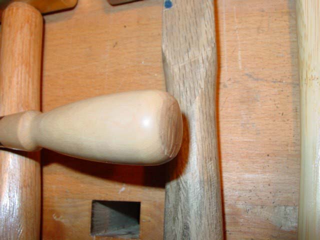

Manny
>Don't worry about the hornbeam, it's virtually indestructible. In an email correspondence with TLN, he sorta told me to show no mercy and try and break the handle. So, I'm using about a 20 oz Japanese hammer and I also tried the #4 Glenn Drake. I'm using the chisel to make mortises, so the hammering can get pretty violent. There are hammer marks and the end has flattened, but no cracks, crumbling, etc.
