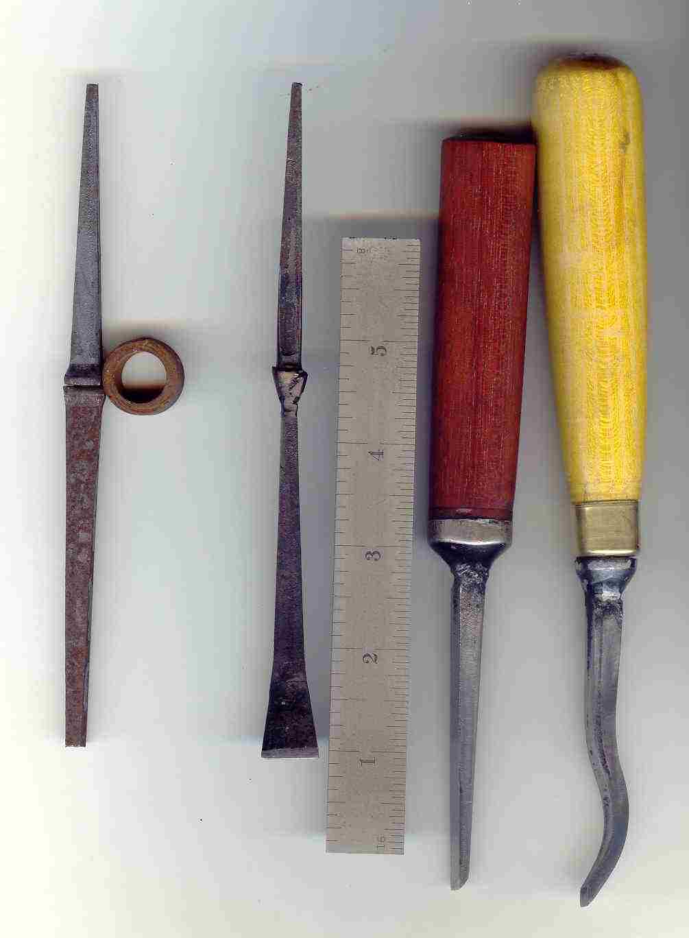

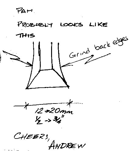

a really common homegrown dovetail chisel
Andrew F in Australia

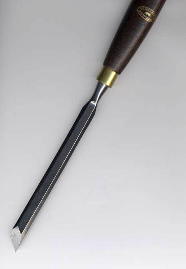

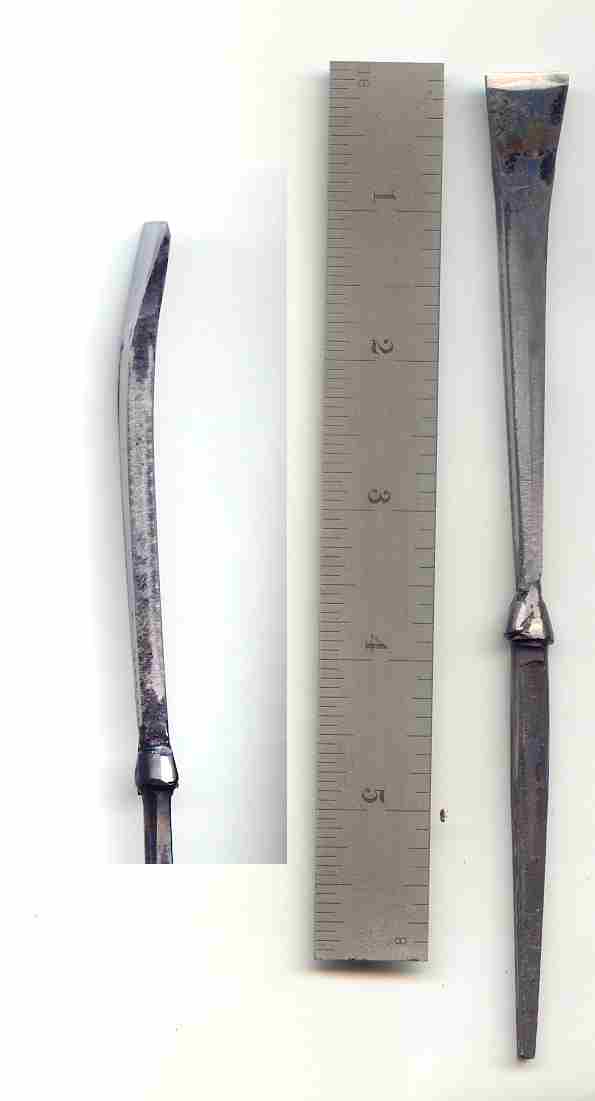

joel
>Toshio Odate designed a special dovetail chisel for cleaning dovetails. He has one sample that he has been using for a few years and we just got his OK on the production samples - so expect to see them in a couple of months. Here's a really bad picture of the production samples.

Re: a really common homegrown dovetail chisel
Pam Niedermayer - Austin, TX
>Thanks, Andrew, I've got some of those, ultra-thin and thin Tasai paring.
>Wow, a partial crank and modified shinoji, very different. Who will be making them?

joel
>THe maker is: Koyama-Ichi
It's a maker who I haven't heard of before but the tools have great fit and finish and seem to hold an edge well. The theory BTW is a paring chisel that can still be occasionally hit with a hammer.
Andrewf in Australia
>Should have added to my original post that the reason I didn't attach a photo is because I don't have one of these, but I know that they're a common modification to cut a lap dovetail socket.
To dig out the corners of a lap dovetail socket, I use a 1/8" chisel, same as Bill.
Cheers,
