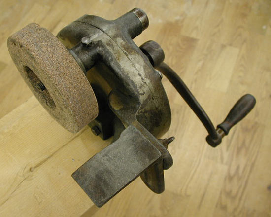

>I acquired this grinder years ago and am now interested in using it for chisel and plane iron sharpening. It has 1:14 gearing and operates very smoothly. I would put a high quality wheel on it and either make a nice tool rest or purchase the Lee Valley tool rest and grinding jig. Have any of you knuckle-draggers tried hand-cranked grinding? At the risk of revealing my ignorance, were these grinders cranked by the same operson that was doing the grinding or was a second person recruited to turn the crank? Seems like the latter would be optimal from the standpoint of controlling the workpiece. Any info would be appreciated!

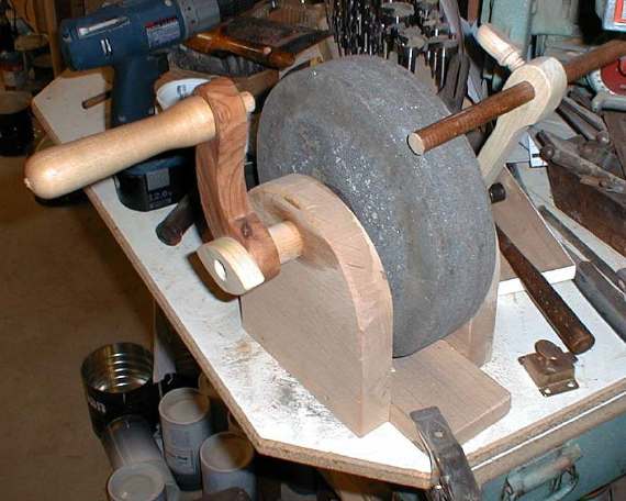

MINE,pretty self explanitory
