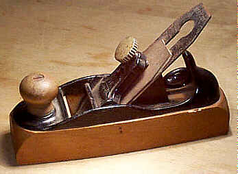

Suggestion
>As I commented on the recent thread on No. 10 planes, my 10-1/2 tote doesn't have enough room for my long fingers, so I kind of cup the tote in my hand (hold your hand as if you were going to wrap it around, say, a hammer handle; now put it on the tote, but don't close your fingers), so my fingers wind up on each side of the iron. It works surprisingly well.
In fact, I have an old coffin-shaped little smoother that I think is a Stanley 122 that, if I just had an iron and lever cap, would make a nice little plane; and that kind of cupping is exactly how you would hold it -- just like the old woodie smoothers.

Re: Suggestion
MikeL in SoCal
>Bill,
The problem isn't lack of room in front of the tote; it's that the tote is too short so the horn jams into the web between the thumb and forefinger. I don't think the tote is original since it's made of a different type of wood than the body of the plane. Also, it's kind of crude looking; with a short, rounded horn. If the horn had a long, graceful sweep like so many older planes have, I wouldn't even be able to grab hold of it. I'm thinking of cutting off the top of the tote and gluing on something that's more appropriate. Unfortunately, that's item number 35,295,798,928 on my list of things-to-do.
Cheers,
Mike
Re: Why are 4 1/2's so popular

Re: Suggestion
>You're only up to 35 billion on your list? You must be a lot younger than I am, or more organized.
Sounds like you should, indeed, consider a longer tote -- when you have finished the first 35,295,798,927 items on the list.

Re: Suggestion
Todd Hughes
>I have seen more then a few of these craftsman made razee planes that was made out of Lignum Vitea wood and if yours has a dark heavy body I would bet it is made out of it instead of rose wood a wood that would be pretty rare for a plane like this.Tradtionaly these Razee planes were popular with boat builders as was the use of LV wood of course.While I have seen Lignum Vitea body planes a good bit I don't think I have ever seen one with the tote made out of this wood so i wouldn't be so quick to jump to the conclusion the tote is a latter add on.Often these older planes have what seems like very small handles but you have to remember back then people were on the whole much smaller then today.....Todd
Re: Suggestion *LINK*
MikeL
>Hi Todd,
The plane very well could be Lignum vitae since I'm not very good at identifying wood types; especially exotics. There was a smoothing plane made of the same wood and a scrub with that type of wood on the sole in with the same tool set as the jack. These planes are at the left and right of the linked photo with the jack in the middle.
Cheers,
Mike

Re: Suggestion
>Nice looking tool; it would be a shame to replace that graceful handle.
Todd's right, though, and it's not all that many years ago that handles were smaller. Pick up any of the shop electric drills from the 1950's "shiny aluminum" period, and you'll find the same meager handle problem.
