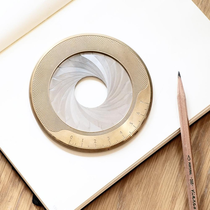

And an interesting tool in picture 5........a type of compass......never seen one like that before.

I purchased this compass a year or so ago, and this is one of the few occasions I have had to use it. Made by Makers Cabinet, and called the Iris. I think it is something out of Stargate :)

Unique......brass......and shiny.......is a combination that tool makers know we find hard to resist.
