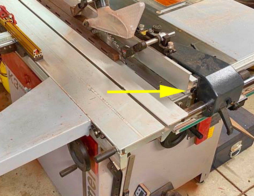

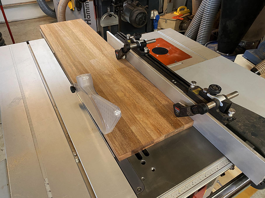

The strength of ripping with the JessEm guides is that they force the board to hug the rip fence. This enables straight rip cuts as the board will not wander from the fence. While this may work well with panels, it also work very well with narrow stock.
The main difficulty in ripping narrow boards to that the wheels get in the way of a push stick. What I use is a 3/8" dowel stick with a rubber disk at on end. This is slim enough to work around the wheels. The rod is stored inside the rip fence extrusion ...
You can see here that a narrow board has been ripped.
