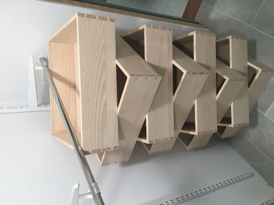

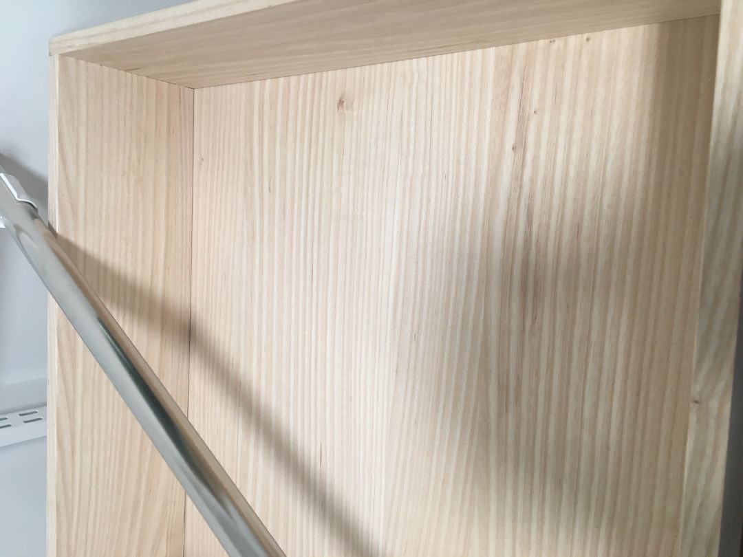

I'm building a bathroom vanity that has drawers of similar size. In my case I used quarter sawn Ash 9/16" thick and used left over ash to make quarter sawn bottoms. Sold wood much stiffer than plywood and with quarter sawn bottoms expansion should not be problem. Ash came from tree cut down several years ago and quarter sawn on bandsaw.
Quarter sawn ash bottom.
 Stack of drawers waiting on finish.

For the joinery on the one drawer I've done so far, I wish it looked as fine as yours. Are they done by hand?

Those are cut using a Keller Dovetail jig set for tight fit and assembled with hide glue.� I typically set the jig up to make tails and pins slightly proud and trim flush.� The ash was too hard to trim with chisel so used hand plane with CPM M4 tool steel blade.� A blade you've seen before. If you index the Keller Jig all of the draw parts are interchangeable.�
Drawers will be installed into vanity with full extension Accuride slides with soft close feature.�
