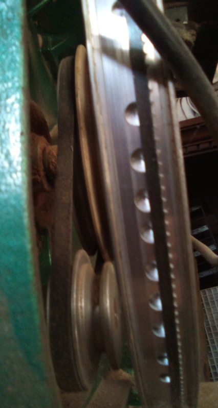

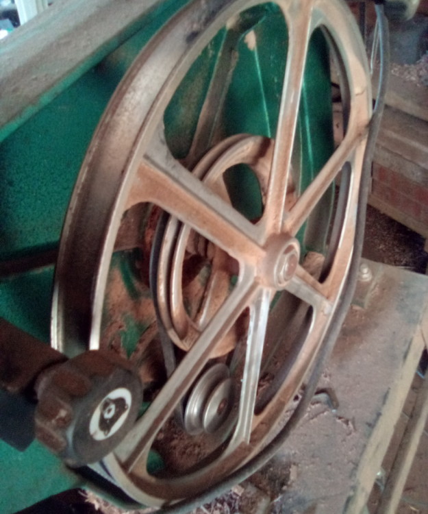

I did some exploratory surgery.
Alan Young
There is a double pully on the motor shaft and a double pully on the wheel. (NOTE the rubber wheel pads are old and have cracked off so they need to be replaced)
The motor speed is listed at 1720 RPM
I don't have the owners manual any more so I can't reference the pully differences.
This current grizzly saw dates from 1992 and it could be used for dedicated metal work if the necessary modifications were worth the effort but I think I'll be exploring something like this dual horizontal/vertical machine dedicated for metal cutting.

You can calculate the speed...
John in NM
You have the motor RPM, you can measure the pulley diameters, and you have the blade length. Should be easy. I looks to me like you can cut brass and aluminum with that saw, a fine tooth blade, and a lube stick - buy that same place as the blade.
