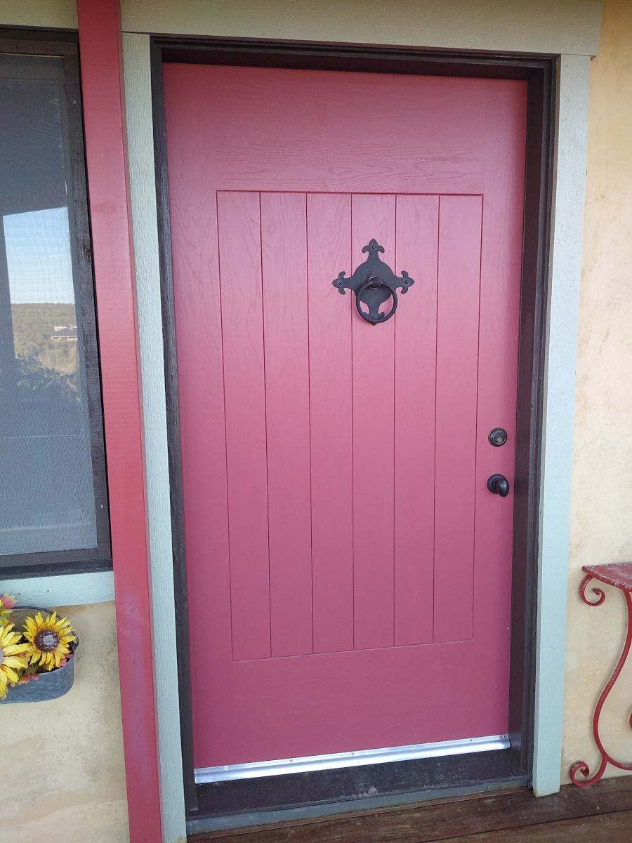

I finally got to replacing our front door. I made several mistakes on the first one I built 15 year ago, at least I managed to learn from those and do better this time around. The material from the old door will make a much needed bench top too :D
Most crucial mistake was in the exterior finish. I never wanted to believe that high quality exterior paint was the best choice for a west facing, exterior surface at nearly 7000' elevation. It is. Primer and 2 coats of premium paint on the outside, regular oil and Waterlox finish on the inside.
The mistake I couldn't easily fix is that it's an odd size - 42" x 84". I originally did that because I like a big opening for moving furniture and stuff. The extra 6" width helps, but it created a problem finding things like extruded sweeps and drip edges. Last time it never occurred to me to look for commercial 48" extrusions I could cut down - this time I found those easily (Zoro tool). So now I don't really call that a mistake :D

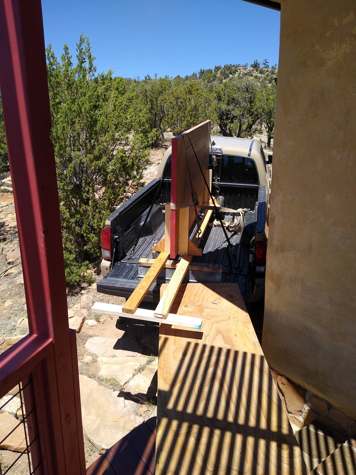

The fun part was figuring out how to move it from the shop up to the house. The door weighs about 170 lbs (white oak). Luckily I had a cheap engine hoist for moving machinery and some discarded lifting straps from my last job, so it was easy to pick up from laying flat on saw horses for finishing. Then the trouble is to move it without a huge effort.
If only I had a really big hand truck...
Wheels are from a harbor freight hand truck - easily borrowed since the thing is so cheap that the axle is secured with cotter pins!
Just screwed my door stands down to the 2x4's and made a quick axle block for the wheels and I have a 10' hand truck.
With a plywood ramp it went in and out of the truck easily:
One nice thing about living in a hilly area is that most of the porches are right around tailgate height.
On the porch, ready to take off the dolly:
Once I got the dolly taken apart and the door sitting on the porch I got some help from a couple neighbors to actually fit and hang it. I can pick the thing up if its already standing, but going from the door stands to standing up is too much for me to handle the weight.

Nice door, beautiful work. Thanks for posting. I just made a table about that size of white oak so I know how heavy it is. I like your dolly and may copy it for the table delivery.
Also thanks for the commercial door threshold Idea. My cousin has and oversized front door and is struggling with threshold and weather-stripping parts. This may turn out to be a big help.

Really nice door .. lots of character. Was there any thought to having it open the other way ?
Barry, indeed, what does it mean to have a red front door (I'm a bit afraid to ask, having recently painted our front door tomato red ?

What is the framing like on the hinge side? Any extra trimmers?

There is a post of 3 2x's between the window and the door, which is the hinge side. Sometimes I put a 4" screw into the framing from the hinge, but I didn't do that in this case since I had put in the jamb with 5-6 3" screws. If I don't do the jamb installation I don't always trust that it is sturdy and put a long screw through at least the top hinge.
Jamb is made of a 2x6 because I had some of the nicest framing lumber I had ever seen at the time. Picked something like 30 off the top of a unit and more than half were actually stamped #1 and a few SS rather than #2. Figured I would make a jamb out of some of those since I had them and was trying to economize back when we built this place.

My wife has a thing about which way doors swing.
I don't always pay close attention, often just doing what I'm told (had to be some area where I would just do what she says, right?). In this case I think she wanted the swing direction to help define the entry area as distinct from the living room to the left as you go in.
I tend to like left hung doors because then the key is in my right hand with my left on the knob. Practical is what I call that, fortunately I also don't always pay attention to what Jean calls it! :D

Just watch out for steel parts in those aluminum extrusions - I put a brush sweep under the drip edge with this one and though the housing is aluminum the bristles themselves are crimped in a steel channel inside it. Aluminum I'll cut with my chop saw, steel I tend to go find the right blade or use an abrasive saw.
