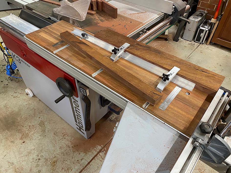

I have had a Hammer K3 Winner with one of the shorter wagons (1250mm) for a few years now. I do not work with sheet goods, only hard wood, so this "short stroke" is ideal for the furniture I build.
Many assume that these sliders are designed for crosscuts, as in the picture above, but they are even better for ripping.
I recently added a parallel guide to the wagon ...
Those familiar with sliders probably know of the Fritz & Franz jig (watzat? That's for another time). Well, this parallel guide is a F&F on steroids :)

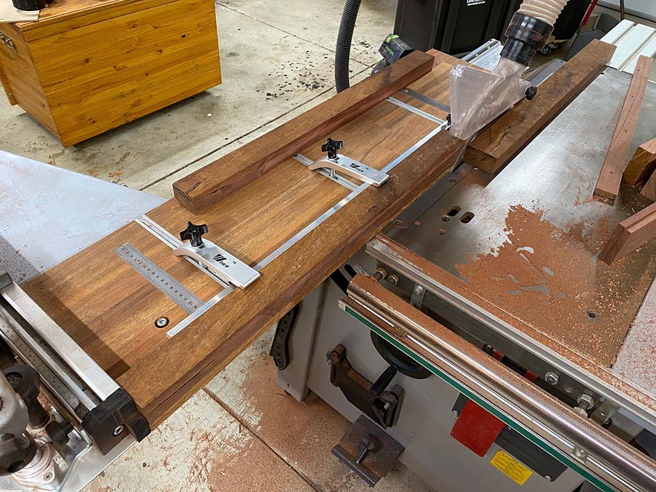

No, I haven't forgotten about the slider. This is what the parallel guide on the slider can do ...
With the case done, the next step is to prepare the boards for the drawer blades/frames. I have found a chunk of Jarrah, about 50mm thick and 180mm wide and about 950mm long. This needs to be sliced up into 50mm wide boards (which will be further reduced to 12mm thick drawer blades.
Place the board against the parallel guide ...
... and rip one side to 50mm ...
Now rip the second length ...
.. and the third. How safe is a slider? This is where one stands - well away from any possible kickback (which does not occur on a slider, anyway. And the hands are no where near the blade ...
How good are the saw cuts? Good enough to joint with, and not require a jointer for the edges.
