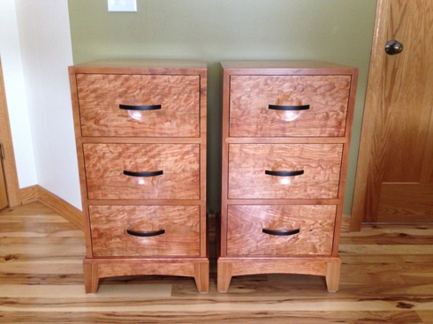

These were a gift for my more than patient wife. She has been waiting for a set since I finished a cherry headboard 7 or so years ago. These took me about a year of build time. Not that I had 2000 hours into them, but work, kids, camping, etc. filled up the majority of my time. These were worked on nights, and weekends.
Size is 34” tall, 18” wide and 16” deep. Solid cherry with dovetailed sides. The base is separate and was attached after the case was complete. The drawer dividers were dovetailed into the case. The drawers are made out of cherry as well. A co-worker gave me a pile of cherry shorts, and I couldn’t think of what to use them for, so they turned into drawers after many glue ups….. Since these will get high use, and I picked them up for next to nothing, the drawers use Accuride under mount soft close glides. This is why I used false fronts vs a more traditional drawer design.
The drawer fronts have a “dish” detail under the handles. It is very subtle in the pictures, but shows up nicely in person.
The piece was sanded to 320 and finished with 50/50 BLO, followed by 4 coats of wipe on poly and paste wax. This is the first finish job that I am really happy with. It turned out glass smooth and just begs to be touched.
All in all they turned out well. If I had to change anything, I would have changed the spacing on the pins and tails for the case. Constructive criticism is always welcome, as I am typically my own harshest critic.

Very nice. I like all the curly grain on the fronts. They will only get better with age.

wonderful craftsmanship. My only comment would be that I would have preferred a more graduated drawer size from bottom to top. I know the camera angle doesn't help, but the top drawers appear to be taller than the bottom ones. The eye may do the same thing when looked down on. I use wider rails on the bottom of doors for the same reason. Love cherry, and I applaud you for not adding any color to that gift of nature!

Thanks for the compliments. The drawers are all the same size, 8.25" tall. I got a little lazy and didn't graduate the sizes. I thought about it during the design stage and wanted to get started,so it got left behind.
Another addition would have been to miter the corners for the carcass. I wasn't comfortable with the technique and decided to push my skills this time with the base. I've never fit and mitered molding around a base before.
I've created some panels with larger lower rails and the effect is noticeable and more pleasing than if they are the same size.
Thanks for the critique, we are typically blind to our own design misses.

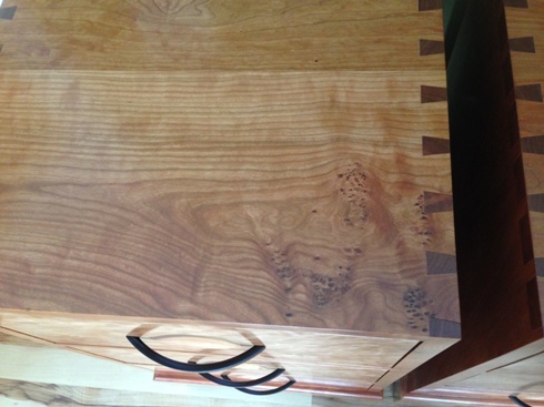

Looks like you used a dovetail jig for the dovetails. Some like the Leigh allow you to set the spacing. I think the spacing on the case is okay but I like to see them a little further apart in that application.
Given the depth of the drawers, I would probably have a few more there. One thing to pay attention to when setting up the jig is that you start and end with a half dovetail. Looks like you tried but the ones in the drawer picture look a little off.
Nevertheless, nice job. It's not easy starting something like this and keeping up with what you're doing when you pick it back up each time. Each project we do teaches something we can take forward to the next one. I really like the base and can fully appreciate the fitting it took.

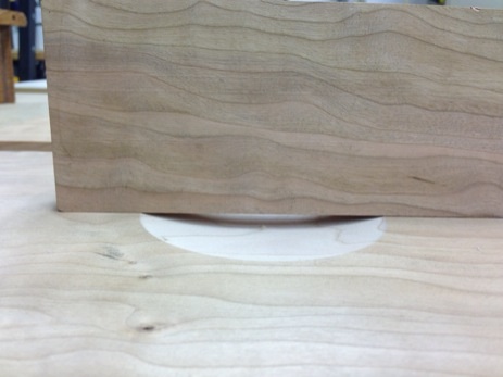

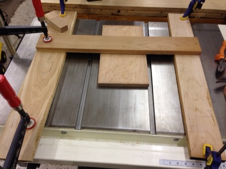

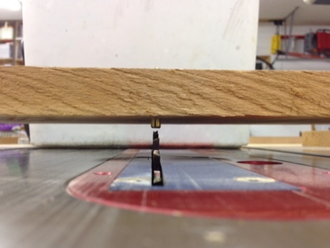

I agonized over the creation of the "dish" in the drawer fronts. My first inclination was to create a jig for the router, but didn't think it would get smooth enough, then I was going to turn them on the lathe and cut them like a bowl. While I can turn a decent bowl, making six identical would have been a stretch.
I ultimately decided to make a jig and use the table saw. Think cove molding, but the piece is rotated, not slid.
The trick was to have the center point perfectly aligned. Otherwise the dish would be of center, or shaped like a doughnut. A little trial and error was the key. I also drilled a shallow hole in the back of the drawer face to accept a dowel pin.

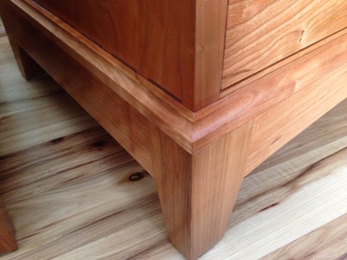

I like the feet
You may see them again on the chest of drawers I am building. Will you provide some details as to how you made this bottom foot section?
If you had graduated the drawers the bottom one would have been too big....I think. To my eye the three equal sizes work ok on what was made. I would have added one more dovetail to the drawer sides.
Ogee (I think that is the word, cove followed by a quarter round) molding is traditional bottom molding. It may be less a dust catcher than just a cove that has the flat top surface.
Mitered molding is easy to do if you have patience and a shooting board to nibble tiny increments off the miter until it fits perfect. Given what you have accomplished you will have no problem mastering this technique.

I like the feet too, but I was thinking about what it would look like with the similar feet that are flared out at the bottom. What little designer brain I have sort of likes the flared feet, but my practical Engineering Side worries they would get beat up and interfere with setting them close to another piece of furniture.
One thing you could do is reverse the position of the pins and tails so that the top would run past the side. Just speculating, but we normally run the top over the sides. I don't think the joints are stressed much in this application, so structurally it would not matter. Mitering those front corners would be an interesting challenge for me.

The whole base is a relatively simple affair. The feet are 8/4 material tapered on the inside surfaces. Used a sliding jig on the t-saw so I could keep all my fingers. They rails are attached with mortise and Tennon. I made the Tennons long to increase the glue surface area. The molding is 1/2"x3/4" or so with a small cove. It is glued directly to both the rail and feet. I wasn't overly worried about cross grain movement on 2+" of end grain as it will sit in my conditioned house.
I comepletely sanded the case before fitting the molding on so I could ensure a tight fit.
The base is adhered to the case using 1"x1" fir strips glued to the inside of the rails. Screws are used to attach it to the case. Tight fit up front and elongated holes in the middle and back to account for seasonal movement of the top case. It's 16" deep and I was concerned about that growing with the seasons.
