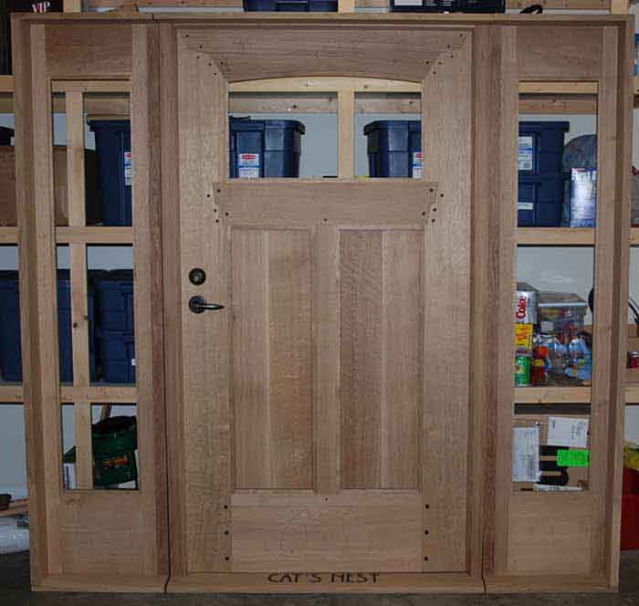

>Hi Everybody,
It's unfinished and no stain glass yet, but I think it's worth to take a look at it as is.
Some finicky joinery there, thanks to templates. All the black pegs and inlays are ebony.
Owners are obviously cat lovers, I thought I mention it in case you haven't caught on! ;-)
My only complaint is the cheap hardware on it, but hey... It flows and that's what matters.
Number of pegs on the "in" side are fewer (only two on each joint, but staggared with the pegs at the front. I figured it'd look too busy with inside decor, which won't be in full blown G&G style. All pegs are functional, not just decoration.
Sweeper is installed into 3/32"x1" deep kerf. It looks very disguised, yet very effective.
Clients are thrilled, I am happy for that as well as finally opening some room in my shop.

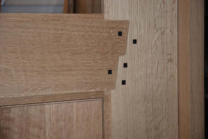

Detail Pix.1

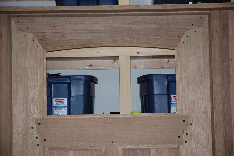

Detail Pix.2

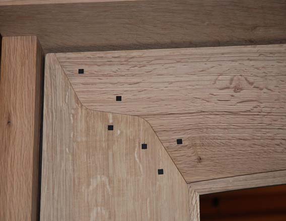

Detail Pix.3

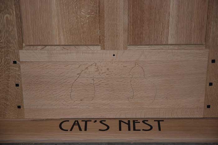

Detail Pix.4

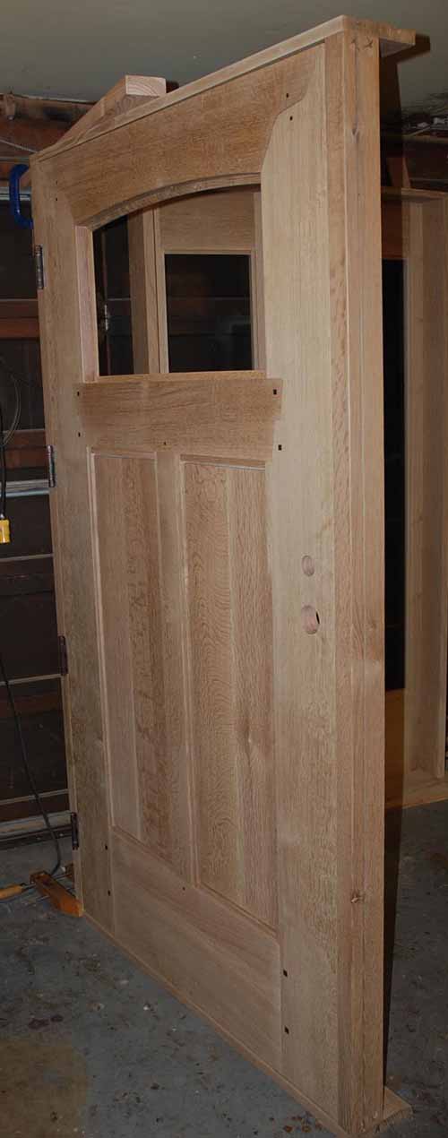

OK, Here are the details...
HC Sakman
>Hi Ellis,
How thick is the door overall and how thick are the panels? Did you use ball bearing hinges? And what's the story with the cats?
Rails have 6-1/2" long tenons. Core of this door is 3 layers of 1/2" thick marine plywood. (Center layer is the tenons and mortises, which are so tight, I had to groove and drill the tenons to allow some air to escape.) It works well once the glue is in of course. Skinned with 1/4" thick bandsawn veneer (That's how the 7" wide stiles are bookmatched) Rails are edged with 1/2" thick oak, rails are edged with 1 to 2 inches wide oak then veneered with 1/4" thick oak. Actually rail veneers are thicker to create some more depth and different reveals at the joints. This is the 4th. door I built with this technique.
You're right about your assumption how the glass will be held in place. 7/16" x 1/2" trim carefully step drilled to receive small scews and the to be plugged with 1/4' oak plugs cut out from the same stock. Side windows' trim will be pinned with 23G nailer. Windows and the solid 1" panels in the door are sitting in foam strip for weather as well as making it rattle free.
I used 4 ball-bearing hinges. Here is the inside shot of it.
Cats....? They just love cats, that's all.
Thanks,
Chico...

Re: OK, Here are the details...Free hand?
lee beeden
>Very nice, ihave always enjoyed the Greene and Greene style and your interpretation is beautiful!! I especially like the cat details, subtle and nice.............were they free hand?
Thanks for the inspiration
Lee
