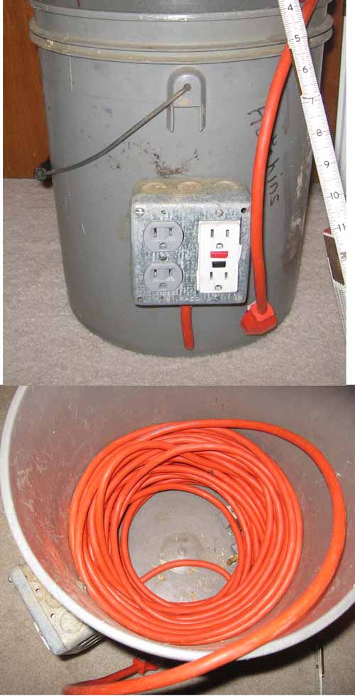

All This Talk About Managing Cords
Robert Hutchins
>. . . led me to take a coupla pics of the way I've been doing it for 30 years or more. The bucket is a 5 gallon container but it's made of a rubberized plastic - not the brittle stuff you see laundry powder and drywall mud sold in. A friend who was working in an ice cream factory at the time gave it to me. They got fruits and syrups in them and just threw them away. Wish I'd gotten 50 of 'em while I could.
The cord is 12/3 from the borg. Started out as 100' but I don't know how long it is now. I think one of my helpers shortened it with a circular saw one day but it was long ago. The gang box is metal, 2" deep with a metal cover plate. The regular outlet is 'behind' the GFCI, so all are protected. I've had a portable compressor, a power drill and two circular saws plugged into it at the same time with concurrent use of as many of three of them (not running constantly but as you would on a job site), that I recall, without tripping anything or the cord getting hot.
I've thought about finding a piece of plastic water pipe to make a central column so tools wouldn't damage the cord, but that hasn't been a problem in 30 years or more since I put it together. In use, it's quite convenient. I put the tools I need in the bucket, walk to where I'm gonna use 'em, removed the tools, take the end of the cord and walk back to an outlet. Reverse the procedure when the task is done.
One man's solution.
