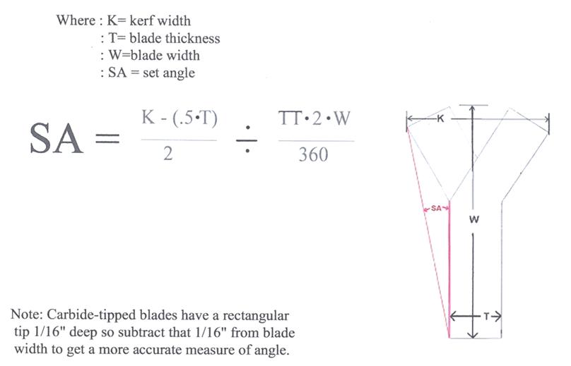

>Regarding "narrow kerf", there is at least one company that makes a 1/2" 0.020" kerf saw blade. is this what you mean, or do you mean 0.025", which is narrow compared to 0.032"? First of all, I can't from my own experience, comment on fine pitched, narrow blades because I never use them. My work is centered on cutting big, thick stuff. That said; 0.020" sounds more like a blade thickness dimension, not kerf . The thinnest blade I have is 0.026" and leaves a 0.064 kerf (Lennox-3/8" & 1/2", 3TPI) Just guessing here but a 0.20" -1/2" blade is going to have to leave at least a 0.025" or more kerf. The easiest way to straighten it all out would be to use your micrometer to find the blade's thickness and use a spark plug gauge to measure the kerf of your cut. I couldn't find any 1/2" blades with less than .026" thickness so I'm curious about that; but if you say so. At any rate, if you're only cutting 3/4" material the thinnest, widest, and narrowest kerf blade you find will be fine. You can "bully" your way through plywood and even burn your way through if necessary but soon as you start thinking about feed rate you'll be looking for fewer TPI and when you start to see drift you'll be looking for wider blades. Correct me if I'm wrong here but I think "thick" and "thin" relate to blade stock thickness and is measured in thousandths; "wide" and "narrow" refer to blade width and range from 1/4" to 2" (or more for mills) "Wide" and "narrow" also refer to relative kerf dimensions. I know it's a pain in the ___, but the answers you seek lie in the understanding of set angles for any blade you propose to use. Try plugging the dimensions of your blade into this formula, just once, it's easier than it looks and you'll never ever use brand names again when referring to blades. You'll find yourself comparing the set angles of various blades and talking about which set angle does what best for whatever kind of cut you're doing. You can believe me; because I never lie, and I'm always right.

I did mean blade width, not kerf when referring to the 0.020" vs. 0.025" vs 0.032" issue. My bad. Olson is the company that makes the very thin 1/2" blade. You can check out page 3 of their catalog, downloadable at http://www.olsonsaw.com/downloads.html
I can see what you mean by calculating the set angle and how that affects a cut. So for my purpose, is there a set angle I should be trying to get to? How about for resawing -- should one go for a low or high set angle?
Also, how much does the shape of the sawtooth factor into this?

>"I can see what you mean by calculating the set angle and how that affects a cut. So for my purpose, is there a set angle I should be trying to get to? How about for resawing -- should one go for a low or high set angle?"
For 3/4" plywood cut depths you only need enough set angle to prevent spontaneous combustion from heat build-up. Two tenths of one degree would accopmplish that. If, on the other hand, you want to rip flatness through 18" of gnarly, twisted, knotty, cross-grained Ironwood you'll need at least five degrees. Between these extremes there are an infinite number of choices; and just as many variables in species, cut depth, moisture content, and operator proficiency. I found that set angles of 8 degrees work best for deep, tight, contour cuts. The trade-off is that as you get into higher set angles you get rougher finishes. I found it virtually impossible to get a baby smooth finish on an 18" deep cut but got pretty close if I went really,really slow: slower than my patience would allow and I over-fed toward the end.
Over-feeding is another subject, but let's go there, too. Take a straight stick and push it up against your blade with the saw OFF. Do it like you were feeding a workpiece into it. It's a big beam and probably wet from lying out in the snow so you'll probably jerk it pretty hard overcoming inertia. Simulate that kind of bladal assault with your stick and watch what happens to the blade (any brand). It's got to turn sideways, right? It has no other way to bend, it's flat and thin. What you'll see is exactly what happens inside your kerf when you feed stock into your saw faster than the blade can cut.. It will curve to just about the same degree as the bow you get when you're over-feeding a timber. Funny how that works, huh?
Back to the original question: how much set angle for flat rips? If you want absolutely, positively, no exceptions or excuses flat, fast, and grain-be-damned rip cuts in whatever you find lying around no matter how thick it is to cut up; go with at least 6 degrees of set angle. It'll look like a chain saw went through there but you can sand it out and you won't have to plane out 1/4" of terrain park scenery. If you can do the same thing with 3 degrees, you'll get a smoother finish (smooth-er is another relative term)

>I went to the trouble of setting up an Excel spreadsheet to play around with numbers. Interestingly, the one piece of information that is never on the bandsaw blade manufacturer's website is the kerf width of the blade. But at least I can plug numbers in and see what combinations will give me a set angle of 4 degrees, 6 degrees, or whatever.
