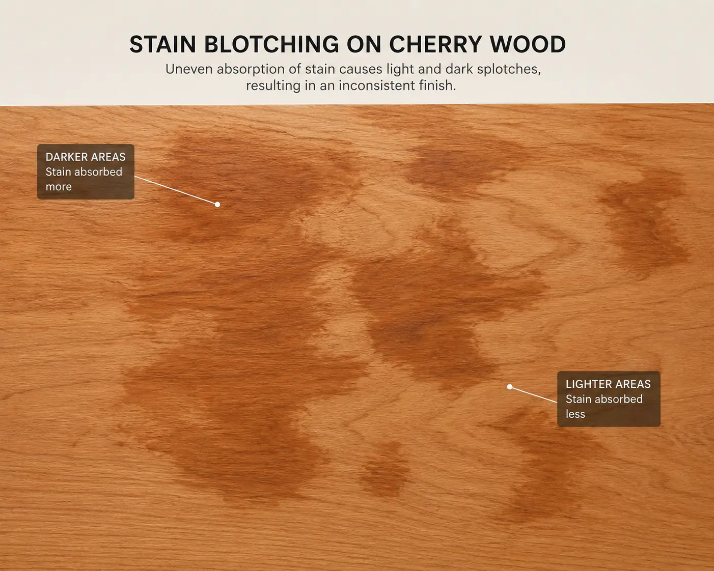

How do I prevent blotching on cherry?
Preventing blotch on cherry is one of the most common frustrations in woodworking — cherry is beautiful but very prone to uneven stain absorption because of its varying density and ray structure.
