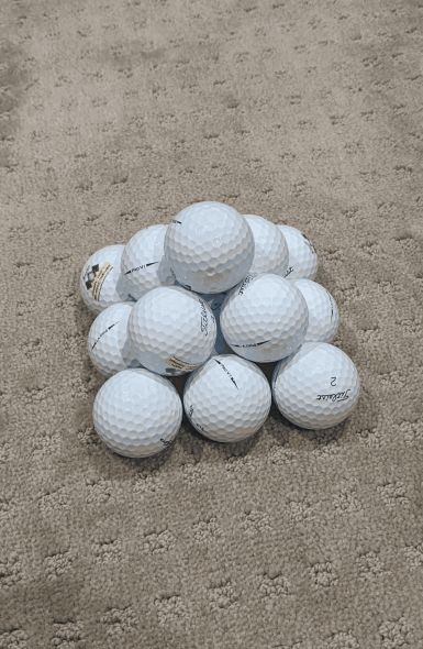

Sometimes at an upscale practice facility, there will be a pyramid of practice golf balls at each station.
If that pyramid is four layers of golf balls, how many will there be in all?
In general, if the golf ball pyramid is n balls high, how many will there be?
Here is a pyramid 3 balls high, in case there is any ambiguity in my wording.
