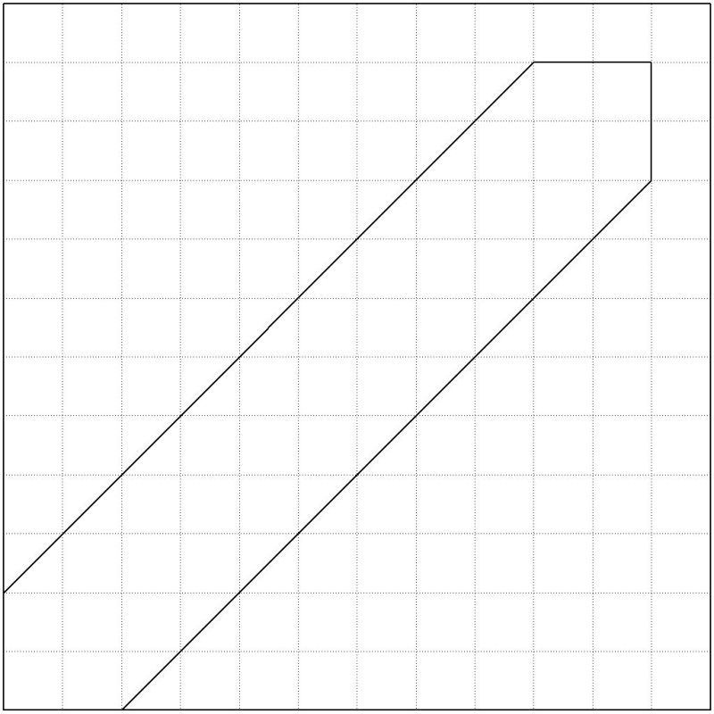

I'll just cut my picture back 5 minutes on the last side.
That'll give me (for the equal probability middle part of the picture) (35/60)*(1/3) = 35/180 = 7/36
Then mash the two ends on again at 2*1.5*((1/6)^(2)) = 1/12 or 3/36
so 10/36
or 5/18

To illustrate the solution David is talking about, here is the diagram. Think of Ben's arrival time on the x axis and Jerry's on the y axis. The inner shape is the solution space, diagramming the parts David mentioned.
The area of possible arrivals is 3600 minutes^2. I've put a 5-minute grid on this diagram, so the possible arrivals are 144 squares, while the area inside the solution space is 40 squares.
