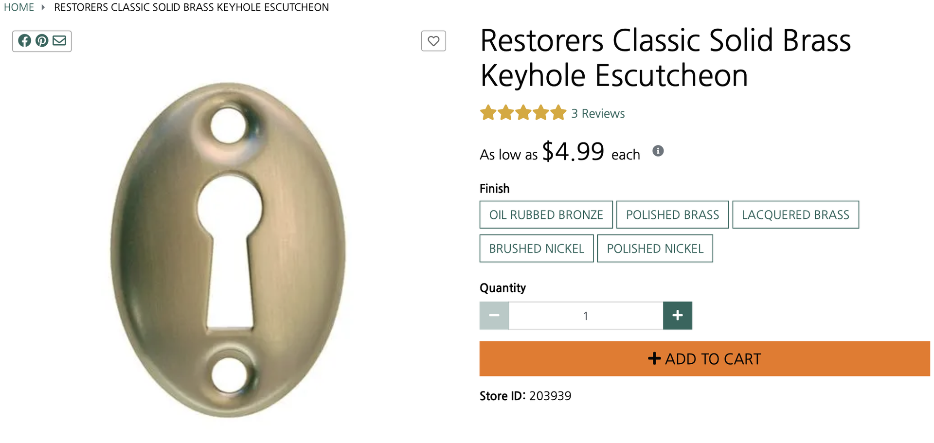

You'll need to make a face-grain plug of oak using a plug cutter that matches the size of the hole. Glue and pare it flush, stain and finish. Or create a fake keyhole like this:

Starret used to make this thing called an Oops Arbor.  It goes in the hole saw set up in place of the drill bit and has threads for both sizes of hole saw.  Using it, you can cut a larger hole using a smaller holesaw as the guide for the larger one.  I can't tell you how many times I've used that thing, but it's a lot.
That said, I would probably install a cam lock (I bet that's what the hole was for) or cover it with some kind of key escutcheon plate.
