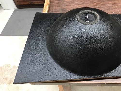

For stippling surface texture on larger pieces (turnings or flat work) I went John one better using an air-driven needle scaler (welding tool) with the needles rounded.

I use a needle scaler too, only with the needles sharpened to a point.  The stippling style I do is a more aggressive pattern used on gunstocks & grips.
The scaler does work really well, but I have had some trouble with control and a lot of trouble with durability of the various parts - both of which go hand in hand with such an energetic method.  Usually I do the bulk of the stippled field with the needle scaler and fill in the edges with the Foredom chisel handpiece.   I have to keep the time spent at a minimum, trying to keep my prices low (and generally succeeding at that).
The handpiece is modified by moving the interior spring to the other side of it's shaft so that it engages the reciprocating mechanics without forward pressure.  Works a treat.
