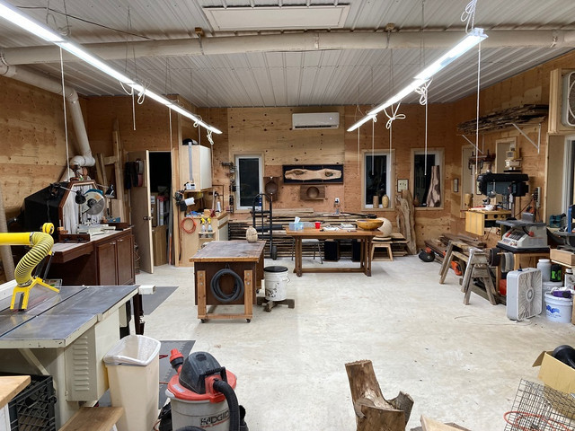

Regardless of the surface, paint it white for more light reflectivity.
Also, think about running utilities before and/or after installation.  In my shop, I found that running EMT conduit on the wall was a lot easier than trying to guess where placement should be.  Planning is key, either way.

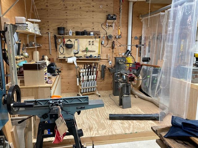

It goes by a variety of names, but chip board or oriented strand board works for me. It's cheaper than plywood, stronger than drywall and it'll hold any screw-mounted shelf, peg board and or the channeled board that's all the current rage. It'll take paint well and leave a textured finish that has a little character. It'll also work for ceilings in the thinner grades.
Re: Walls for new workshop
For a wall where I want to mount tools, paper towels, and maybe a pencil can and 3x5 cards I don't like pegboard, mostly because the hangers that go into the holes aren't very secure and they may not fit my tools as well as something I can easily make. I've used 1/2" plywood but Dave's suggestion of OSB would work just as well and be less expensive.

I use clear shower curtains for my movable screens.  I stretch 1/8" cable for the "curtain rod".  They work great.  I've had the same curtains hanging behind me at the lathe for years.  A little beat up, but they do the trick.
