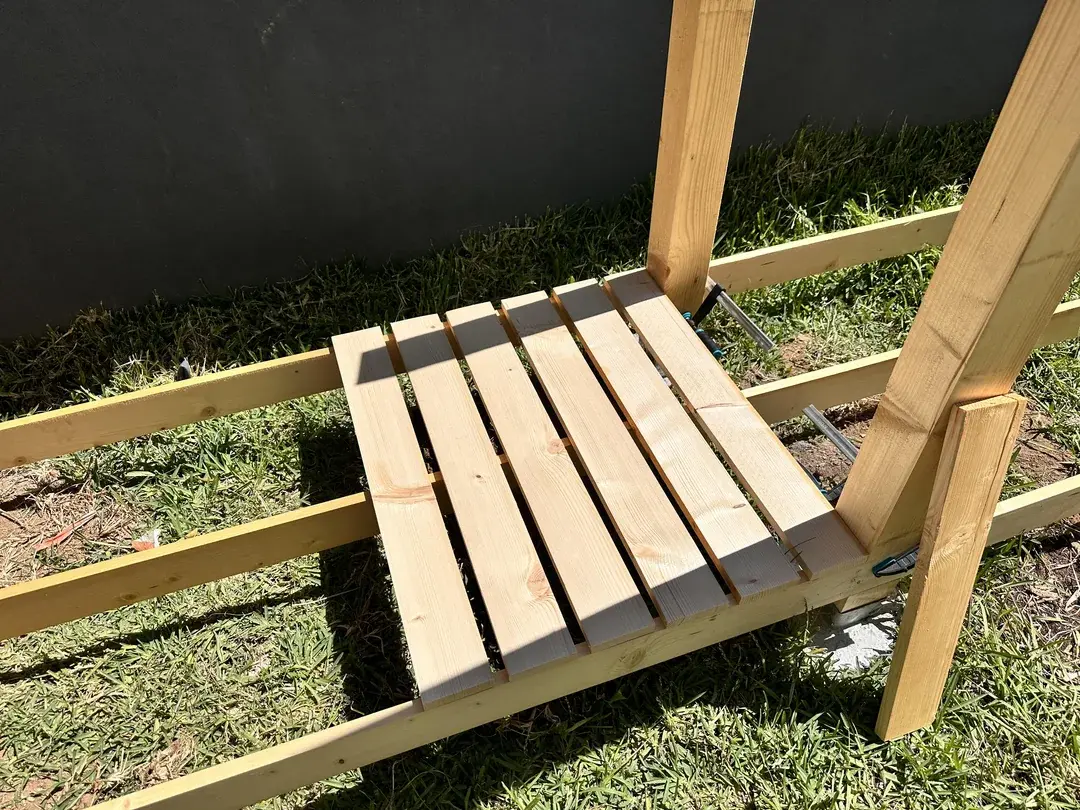

This is not my project but from Reddit. The poster asked how many screws to use, but my question would be are the 2x4's sufficient to support firewood? As for the screw question, their answers ranged from just one on each outside joist to two in each one, so no definitive answer there. Would using more screws provide increased structural integrity?
What say y'all?

Them's 1x4's I think.

I think you're right, and I see others on the Reddit post have noticed the same. So I guess the question isn't "How many screws?" (the title of the Reddit post) but addressing the framing first.

2 placed on diagonal

Well, it looks like the outside rails are let in to the posts, so one screw to keep them there (and some good glue like TB3) would be fine.  When doing the same with 2x material and half lap I've used two on a diagonal just because it doesn't hurt and might help a little with cupping.
Not much point in sweating it though, it's not going to last.  To do that it will need beefier parts, diagonal bracing, cross supports between posts the short way, etc.  And a coat of paint or two for the weather.

I have some plastic brackets that you sick a couple 2x4's in them horizontally and 2 short 2x4's vertically on each end and it has held up well for years. Granted it's only wide enough to hold a rick, not half a cord. Why in the world woud you put floor boards on it?
