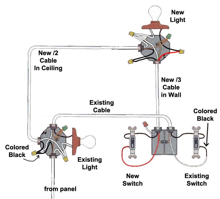

Adding new light to existing circuit
Is this correct to meet the current (pun intended :) ) NEC?
Re: Adding new light to existing circuit
Yes, that would do just fine.
