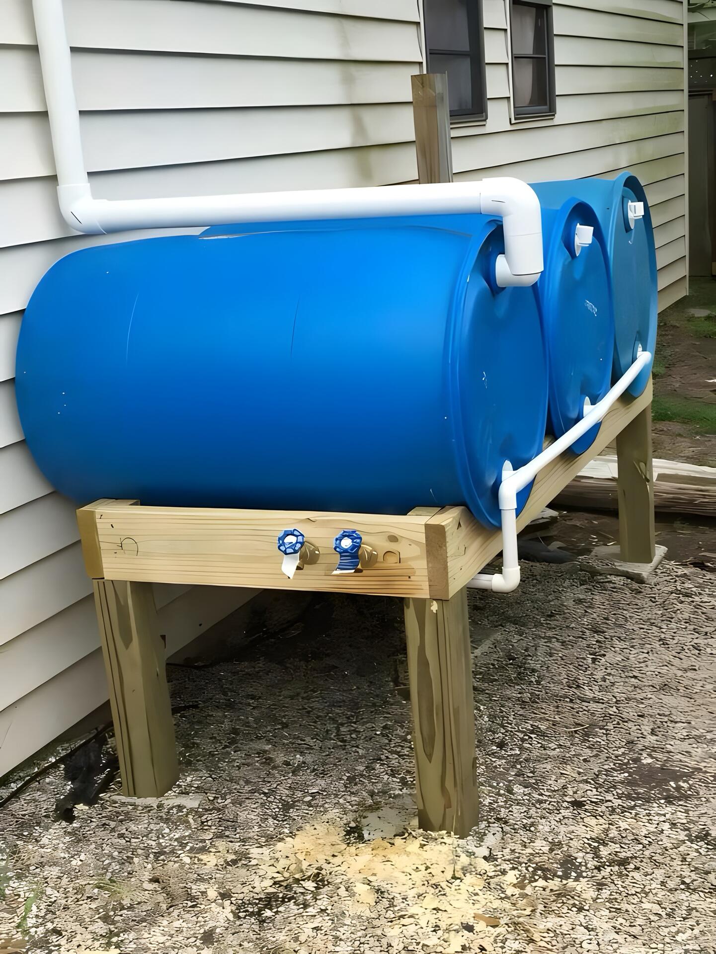

Not mine but from a group about about rainwater collection. Each of these barrels is going to weight about 500 lbs when full. Are notched 4x4s sufficient? And the cuts in the 2x8s for the barrels create a weak link, and I would expect them to crack at the center barrel at some point in the future. Some are saying it's fine, others say he should have used 4x4s all around, or at least add center legs. Opinions?

I would use 6x6's for the legs notched on 2 sides to support the rails. That way solid woods supports the rails rather then screws.

Assuming there is at least 3-1/2" remaining in each 2 x 6's supporting the barrels and the total weight of water and drums is 1500 pounds, the beams will only sag ~0.1 inches.  I think they will last a long time.  The main weight is supported by the notches on the legs.
Re: Supporting heavy stuff
@Lee Schierer, Are they 2x6 or 2x8?  I originally posted 2x6, but then looking at it closer, they looked (to me) to be twice the width of the 4x4s.

While 2x6s can carry that weight, the barrel notches make them into about 2x2.  A center post notched to carry the weight would be a good idea.

The Sagulator can help:
https://woodbin.com/calcs/sagulator/
The relevant numbers are the length of the supporting 2x6's their thickness (1.5 inches) and their depth (hard to tell from the picture but call it 2 inches). And the weight per support (1500/2). And assume a uniform load since their are three loads more or less evenly distributed. You also need to know what wood is being used.
Other things: the 4x4 posts can support many times that weight of about #375 each. I agree that notching the tops of the posts so the rails sit on post end grain is far superior to merely screwing or bolting the rails to the sides of the posts.
Also, it looks like those posts are sitting on flat rocks on the dirt. I'd feel better with some crushed rock for drainage and a concrete footer under those posts. Or a concrete deck pier.

Am I missing downstream fill lines to the other two barrels?
Easy solution for load capacity: Fill the barrels up and see what happens.
