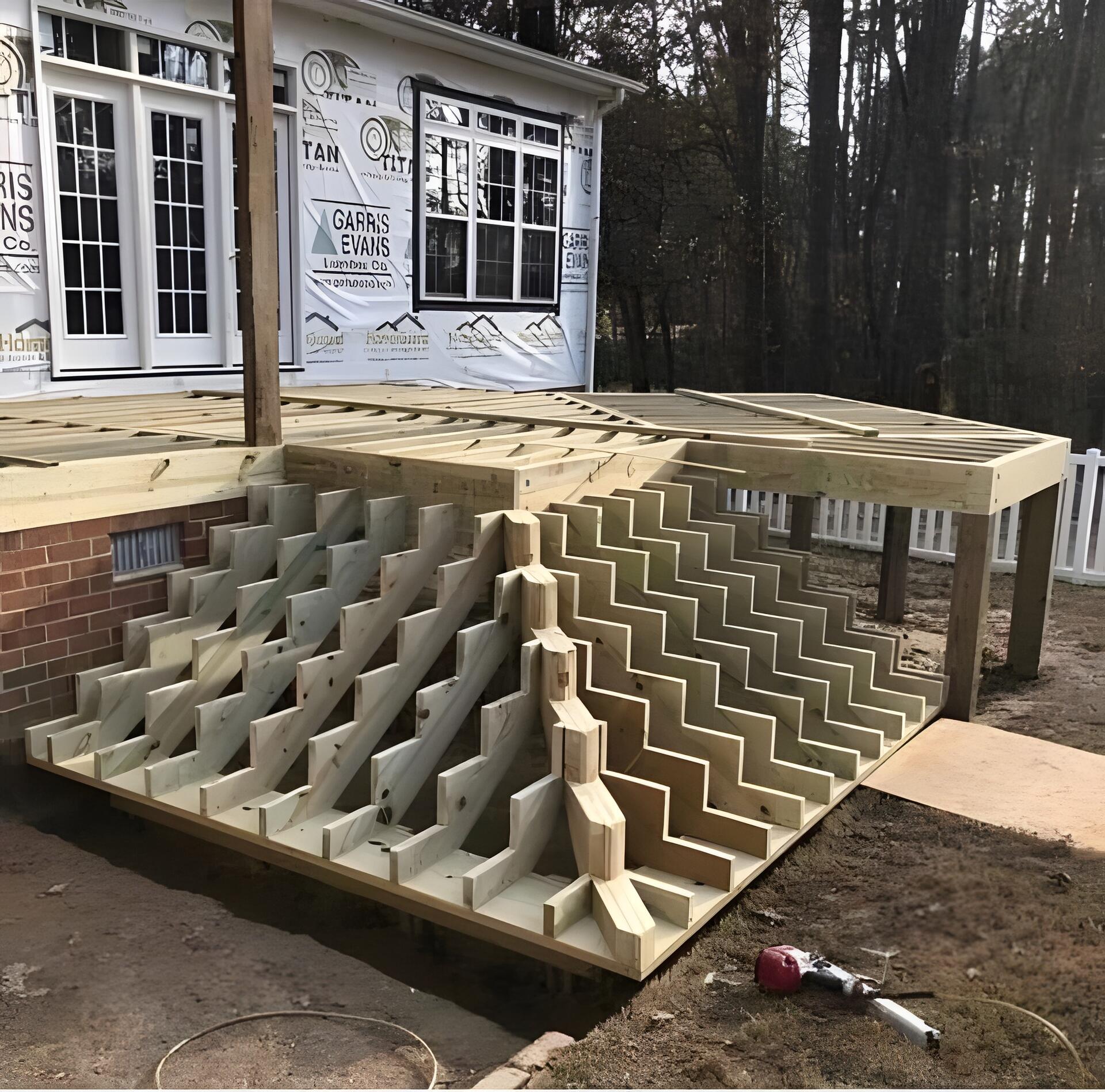

Load rated for Taylor Swift and her entire dance troupe ?
Re: When cabinetmakers build a deck
Jason Roehl in Lafayette, IN
I kinda like it, but...the deck to stairs ratio is pretty low.  I'd rather have a lot more usable deck space.  Nothing wrong with sturdy steps!
Jason
If that's a full sheet of ply on the ground it looks like the stair stringers are 12" apart so he may be using composite for the treads.
I think the set running parallel to the house are useless. There are a couple of houses around me that have concrete stairs like that (although smaller) and it is obvious the parallel set never get used other than a plant pot or two.

I'd like to see the finished project on how they handled the stair railings and those around the deck to meet code.

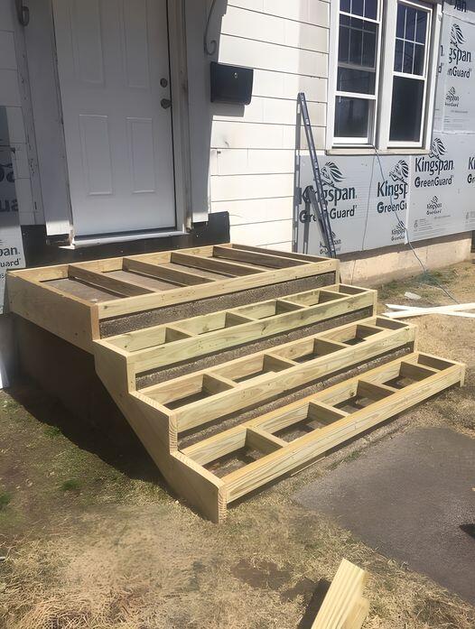

This guy/gal took the opposite approach. Will this work? I fear a fat guy running up the middle may bounce his way to the top.

This guy/gal took the opposite approach. Will this work? I fear that a fat guy running up the middle may bounce his way to the top.

I would think that those steps would be pretty solid.
@Lee Schierer, Probably, they appear to be two 2x6 which should be OK. Also, it appears it is built over a concrete stoop, so if touching, you can't make inside stringers nor do you need them.
