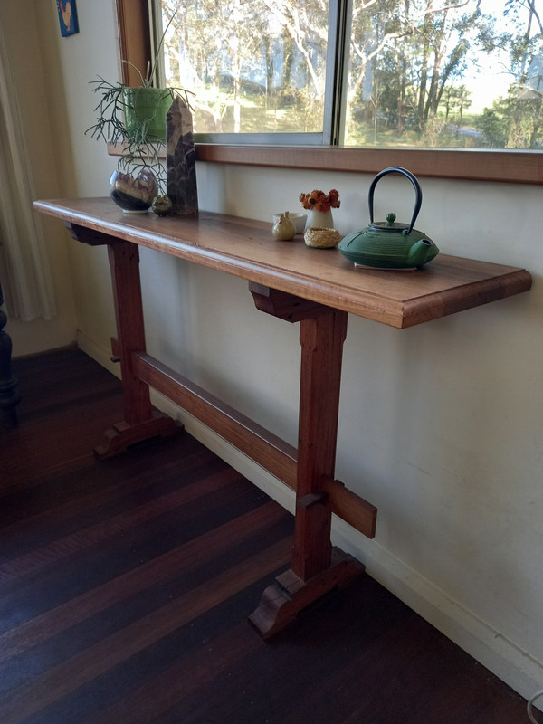

In reply to a request. This humble side table was my first break in project once the shop was up and running. It's made from recycled bearers and joists from a neighbours timber rack. So it's got nail holes and stains all over it.
It is inspired by typical Renaissance construction techniques whereby a long tenononed stretcher holds the two legs together with a horizontal wedge of Jarrah.
The scroll feet and upper brackets again are an Italian Renaissance feature common on Harpsichord stands, side tables and dining tables. Since the Top is quite narrow I drilled pocket holes under the brackets and used carriage bolt's to fix the table top down.
The carriage bolt's were recycled gate hinge bolts. The pocket holes are bored oversize to allow for movement.
The feet and bearers are through wedged mortise and tenon.
The table is now 25 years old. Simple, tough, stable.
I made it in one day to test the machines were running OK.
The mortises were cut with a Muti mortiser..

Hi Maurice. I took the liberty of adjusting your photo to make the joinery more visible. I do like exposed joinery.

Ah yes, that's much better. Not a computer wizz myself.
It's a knock down piece of furniture from a time when this style was very popular.
It's simple, stable, economical on timber use. I made my dining table the same way.
Only difference is vertical wedges made of
Laurel. Don't burn that weed timber. It's  excellent useable stuff. As is privet.

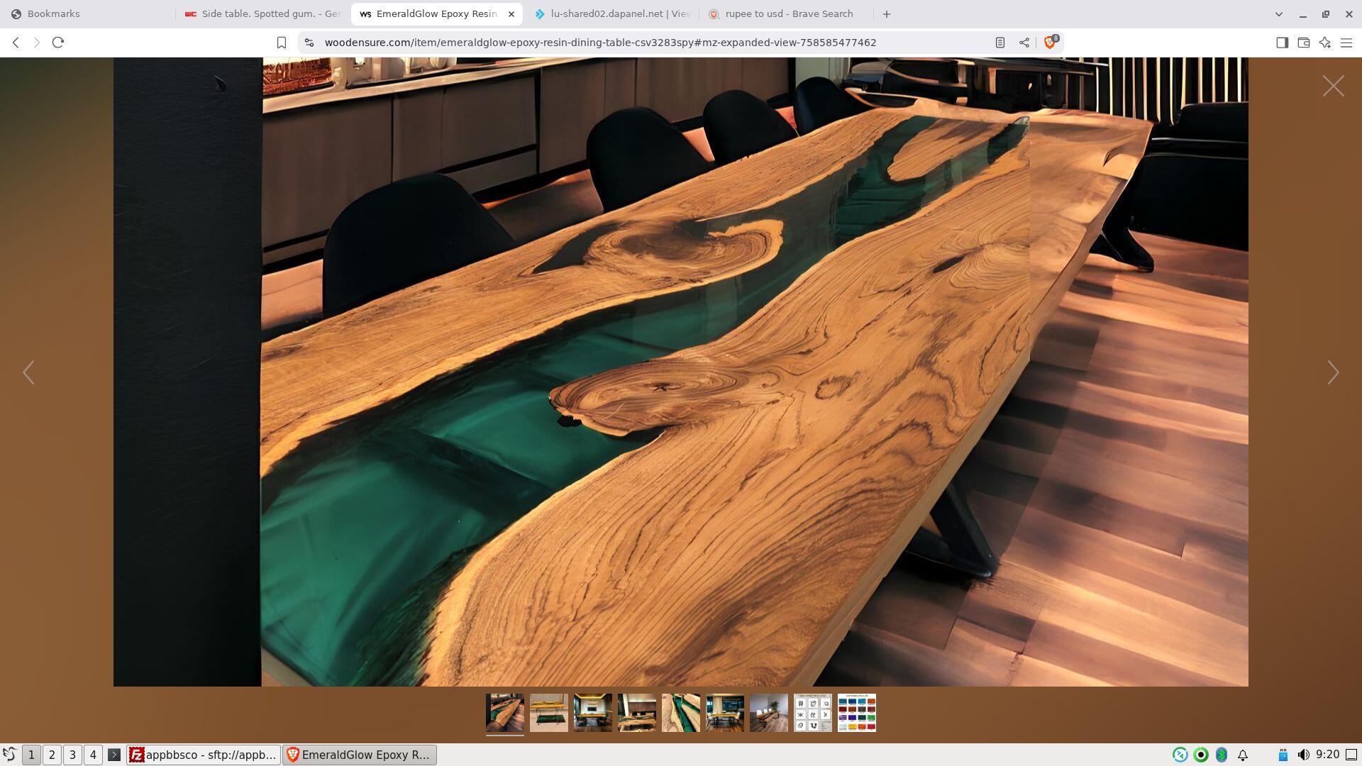

They were trying to market mass-produced tables to an audience that prefers making their own, not purchasing pre-made furniture. In some cases, these products are even linked to exploitative labor practices, such as human trafficking operations in Southeast Asia. Human-driven spam often involves this kind of exploitation, and in this instance I could confirm it wasn’t bots -- I use honeypots and other methods to detect those.
The companies themselves are usually not directly involved -- they outsource this kind of work to so-called Search Engine Optimization (SEO) “experts” who run these schemes. Given how polished the site looks, I doubt they’re handling it themselves, so I’m assuming that’s what’s happening here.
What caught my attention was the solid wood furniture they’re promoting. I’ve been amused by all the YouTube hype around “river tables” made from live-edge slabs --complete with stories of wealthy Europeans commissioning one for their yacht at $60,000. It’s pretty enticing clickbait for beginner woodworkers chasing dreams of big money, especially when the videos are packed with plugs for epoxy and all the other supplies needed to make them.
And now here’s a company offering what looks like the very same table for under $1,500. WoodCentral’s focus has always been on sharing knowledge about the craft of woodworking, whether as a hobby or a profession -- but like everything else, economics inevitably factors into the discussion.
I figured I’d ask if anyone has thoughts on this -- not just to keep the forums active, but because I’m genuinely curious.

I view river tables as a gimmic.  Flashy, of course, but lacking a lasting aesthetic.  Gets even worse when they mix pearlesant stuff into the epoxy to mimic a Van Gough painting or a bad acid trip.  Works for bowling balls but not dining tables where you have to hunt for the salt or pepper shakers or need to be cover it with cloth to try to prevent scratches in the plastic.
I've done a couple of tables with center "gaps", but the concepts of a unitized space were preserved.
I did, however, see one table that was way cool.  That was were the center of the table was actually an aquarium, fish and all.  High maintenance, of course, but mesmerizing indeed.           .
