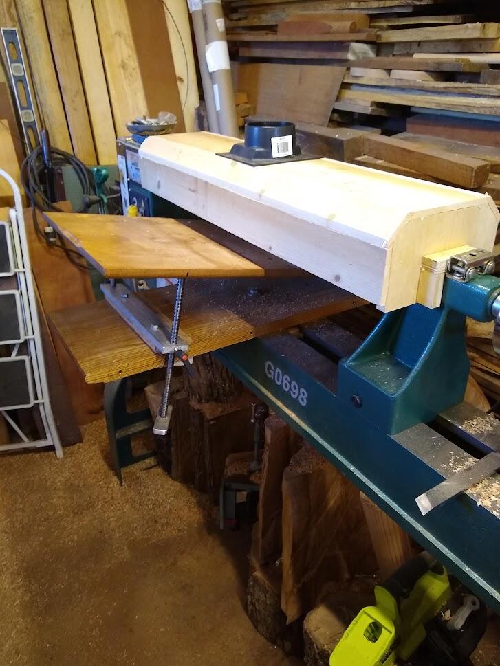

I'm inclined to agree with Ellis on this. But the first place to start is with the bandsaw itself. There are a lot of good videos out there, but I found this one to be quick, informative and no nonsense. https://www.youtube.com/watch?v=vNdrkmx6ehI&t=304s
For what this is worth, you can make a drum sander for your lathe pretty easily, even out of scrap materials.
And even provide semi-effective dust control.
The thing that I would have done with this, is make the platform much more rigid to prevent any possibility of flex. I haven't had time to revisit this project yet unfortunately.
You can make drum sanders of any size though, for different purposes. The duct tape (Gorilla Brand) really does work though I now use a dab of hot melt glue instead of hose clamps.

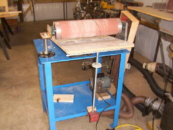

Just a picture of the one I built. I have added dust collection to it.
Re: Drum Sander (small!) ideas, recommendations, experiences?
Thanks Ray.
Any hindsight wisdom on the sander you built?  Happy with the performance?  Get consistently even pieces? Any regrets building one vs buying?  Was it purchased plan, free plan, or your own design?  What do you use it for?
Henry
I built this out of a piece of 6" tube and a couple of flanged bearings. The left side is adjustable up and down. It works well. I do a lot of segmented turning and I use it for flattening segmented rings.
