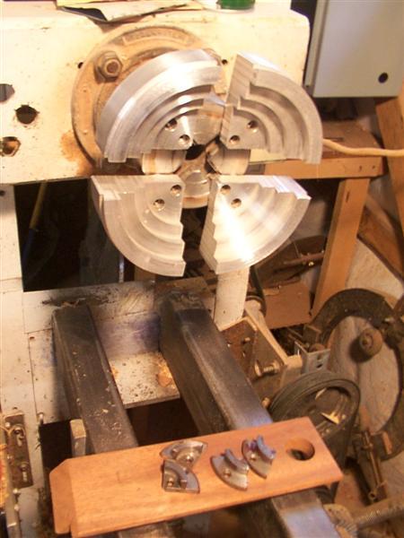

I had some aluminum bar left from a job so I turned these jaws.

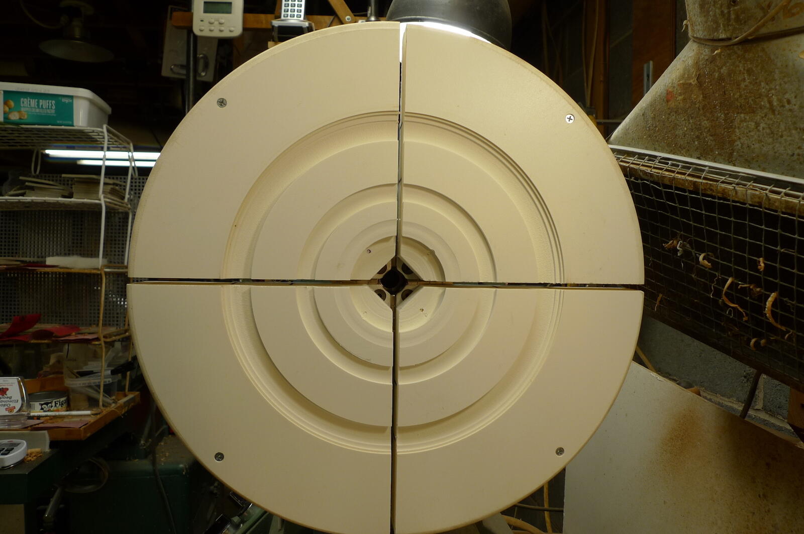

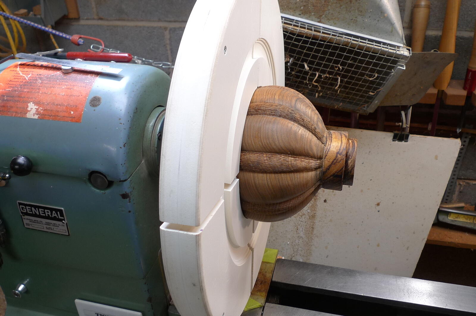

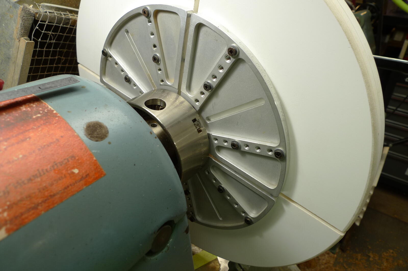

Karl, it would be helpful if you were a little more specific ... size, for turnings, for other items, etc.   I think Flat Jaws may suit your purpose but they can be limiting, size-wise.  I like to use white PVC foam board instead of polyethylene.  You can use regular PVC pipe glue if needed.  This link is a little difficult to navigate but they have a lot of different plastics - probably polyethylene.  Haven't ordered from them since 2015.
https://freckleface.com/shopsite_sc/store/html/product848.html
If you have (or willing to purchase) Cole/Jumbo Jaws for your Talon chuck you can make a larger version of Flat Jaws.  Just remove the grippers ... I hate those things!  I'll try to add some pictures - hope this helps.
