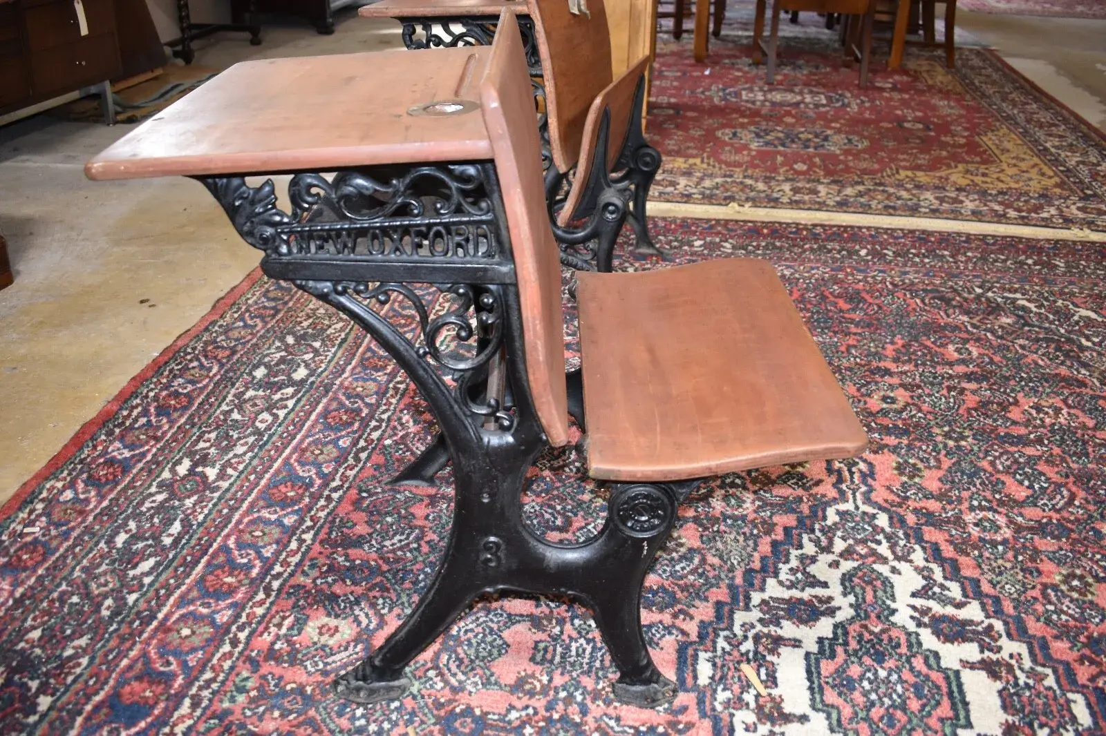

My mom, dad, older brother, and sister attended one-room school houses in Wisconsin, probably built in the late 1800s, where the desks had cast iron frames with a folding seat and looked like this. I don't think this style was used until after the Civil War.
Earlier versions I have seen looked like this.
This was Wisconsin. I don't know how much this varied by location.
My second, third, and fourth grade classes had that desk - including the ink well.  We used the dip pens in second and third grades, but 'graduated' to fountain pens by fourth grade.
