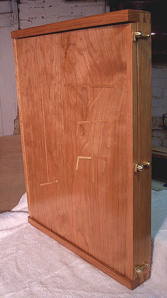

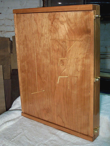

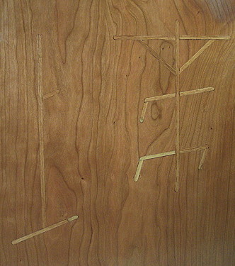

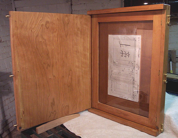

I'm not sure about my "strangest" project- but this one was quite "interesting: "A Chinese Book Cabinet" This wall cabinet is designed to hold a book set in a series of unbound papers. The book is a training manual for a Martial Art form.
The papers reside in an 8.5" x 14" x 5/8" cavity inside the cabinet and are encased with an interior door  of tempered glass.
The exterior door is inlayed with Oak from a tree that was hit by lightning. The inlay forms Chinese Characters that reveal
"The Emperor who rose to Heaven"
The exterior door is held to the cabinet with a series of three hooks and handles handcrafted from brass.
