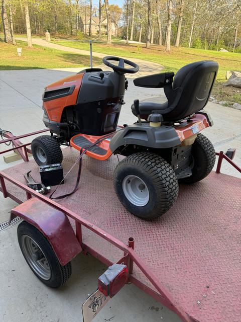

A friend asked me to look at his riding mower.  He said it wouldn't go into reverse all the time.  I took the deck off checked all the linkages when I heard a noise coming from the transaxle.  It sounded like a piece of metal was blocking the shift lever.  I went on line looking for a new transaxle or a parts list for it, no luck.  We then brought it to two different repair shops, and both said the same thing, there are no parts available to fix it, and it is basically scrap now.  The mower has been serviced ever 10 to 12 hours of use and is in great shape.  We called Husqvarna and were told the same thing.  What a waist of money.  If you need a new riding mower I strongly suggest not buying a Husqvarna.

I was changing the drive belt when I heard the noise in the transaxle.  The CVT belt I can find a replacement for, but it is not worth it.  As I was turning the belt I could feel what ever is binding.  I turned the pulley by hand and can feel it also so I know it is inside the axle.
Added later 21 h 51 min 42 s:
Follow up.  Checking the MFG date it shows it was a 2016 mower sold to Lowes.  It must have been stored for awhile, because it was sold brand new in 2018.  The transaxle is made of a composite material not aluminum.  The material has broke down inside the housing around the bushings, causing the issues.
The mower was stored inside a garage (HOA rules) and maintained, it has 218 hours on it.  I did find another with a blown engine in it, just not sure it is worth fixing for this gentleman, he is 82 and has a hard time getting on and off of it.
He is getting a Cub Cadet ZTS series.  It will be easier for him to get on and off (steering wheel), it is a zero turn that does great on slopes.  Now I have to list this on FB marketplace to get it out of my yard.
So I still stand by don't buy one especially if it has a black transaxle (composite).
