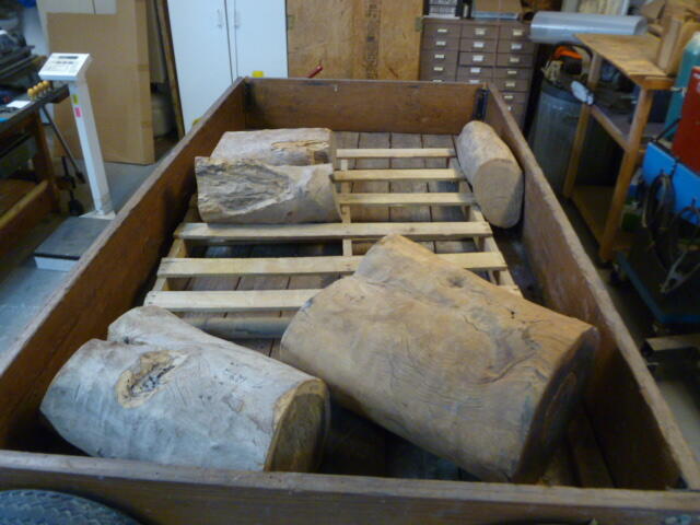

Hi, All:
An old friend moved back east to be with family.  He left me with this pile of Lignum Vitae he brought back from Puerto Rico in the early 60s saying "just slap it on ebay and keep 25% for yourself".  Sheesh.  There is like 600 pounds of the stuff.  I have had it at and exotic wood dealer in Mexico, Mo for years, but he didn't have any luck selling it.  It needs to be broken down into smaller pieces, but he was not willing to use his extremely expensive band saw rig to do that.  I would have to block it up with a chainsaw into pieces I can manage with a 10" table saw.  Then it would take probably a thousand hours of labor to sell it a piece at a time on ebay in sizes that I see there.  One example, a 3X3X12 inch chunk priced at $158 and described as having cracks in it.
Does anyone have any advice as to how I might market this stuff?

You have two choices - saw it into blanks and try to market it for a purpose (pool cues, for example) where the end user has something valuable, or sell it as logs.
Lignum is rare, but that doesn't mean there's a market clamoring for it aside perhaps from museums or historical boat places. and they may have arrangements to get stuff from the source in bigger quantities since they can navigate the restrictions or whatever that would be.
1) saw it and sell off what you saw. Be ready for a relatively low yield compared to what you believe might be in the long and saw the blanks as straight as you along grain directions, which may also increase loss a little bit
2) list the logs on ebay or some other marketing platform and keep lowering the price until they sell
You may want to list a guarantee that it's genuine LV giving the buyer the right to return the wood if they can prove its not, and if you sell logs, provide a guarantee on what amount of the yield inside the logs will be uncracked and undamaged by bugs (no clue if bugs are a problem for it).
If you're selling as an individual, I'd expect somewhere between 10 and 50% of what you'd expect a retail dealer would get for it. If you feel like you should be able to get average proven dealer retail for it, you'll have it for a very long time.

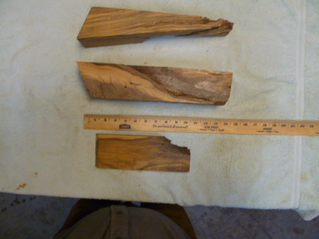

1:  I grabbed the smallest chunk and went to work on it with what I had on hand, ie a chainsaw and a table saw.  David, you were correct.  I was appalled at the low yield.  I got 4 small, irregular chunks with cracks, gaps, sap wood, etc.  I put them on ebay for my best guess of 1/2 what I see on there for asking prices.  Roughly 2 weeks, no hits.  I have already lowered the price.  Concerning "combining shipping" the best I can tell, unless  you have an ebay store, combining shipping and offering refunds is not possible.P1050889.jpg

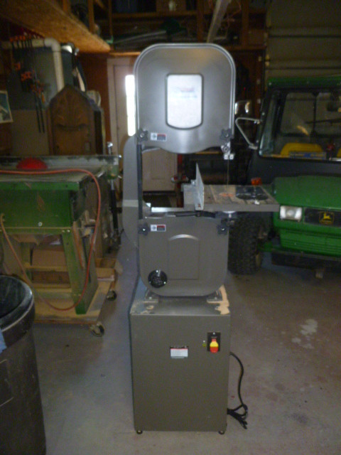

2:  I purchased a cheap 3/4 HP 14" bandsaw (about $500) at Harbor Freight.  I installed a 1/2" X 3 TPI blade on it hoping it would be able to rip this stuff.  Based on how fast it dulls a chainsaw, I suspect John is right that I will need a carbide blade.  Not sure what exactly will fit this saw.  I'll look into it if this blade dulls as fast as I think it will.P1050903.jpgThe rip fence is home made, but should work for what I am doing.

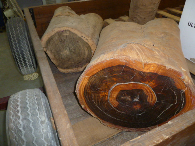

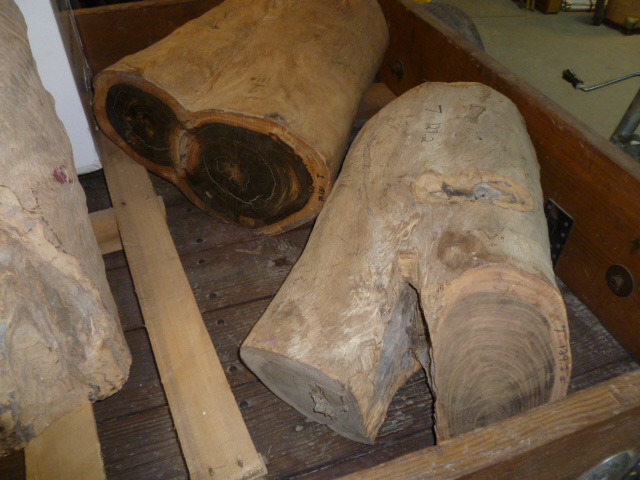

2:  The 2 largest chunks both have crotches.  The largest chunk has a sort of separated center.  My first thought is to chain saw them right down the middle of the crotch.  Is that likely the best approach, or should I cut them differently?  Should I try to isolate that "separated center" out of the largest chunk?  Photos hopefully inserted here:P1050902.jpg

If the pieces you show are the best yield you can get out of the log sections, I'd try to sell them whole as turning blocks and let the customer decide how to dissect them. As an aside, the purchase of the HF band saw could be a concern. I bought one probably 20 years ago and had a small log section get away from me when cutting turning blanks, and the resulting catch broke the blade and bent one wheel (and scared the crap out of me). They may have beefed up the wheel design since, but originally they were made out of thin aluminum, 3 spokes as I recall, and very flimsy. I was fortunate to find a pair of 14" Jet wheels on Ebay reasonably priced which were substantially heavier and were a perfect fit replacement. The saw has worked well ever since. DO NOT TRY TO COSS CUT round stock free hand. It's asking for a disaster, use a sled of some sort to secure the round stock.

Well, the piece I started with was the smallest, and worst condition piece, but I figured I didn't have much to lose there.  Whomever said the market is limited and it would be hard to sell was apparently correct.  I'm getting no hits on the 2 lots I currently have on ebay.
Your assessment of the saw is likely spot on.  the wheels are aluminum, and don't look all that robust.  That said, the right mistake can damage almost any tool.  I couldn't spend 3 grand just to cut up 5 chunks of wood
Sounds like good advice on cross cutting.  I'll keep that in mind, but that will likely be done with the chain saw.  I'll also have to do some rip work with the chain saw just to get it to sizes the band saw can handle.  I just need some idea what size to make the pieces.  The large, crotched piece has the center kind of separated, and is fraught with cracks.  May not cut out to anything large, but I see a LOT of "pen blanks" on ebay that are very small and priced surprisingly high.
