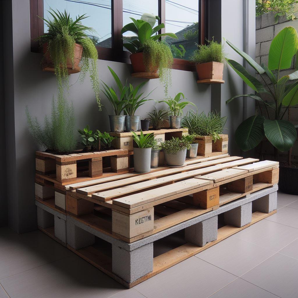

Not having a wife (or g/f or woodworking skilz) this is how I'd do it. ;)
