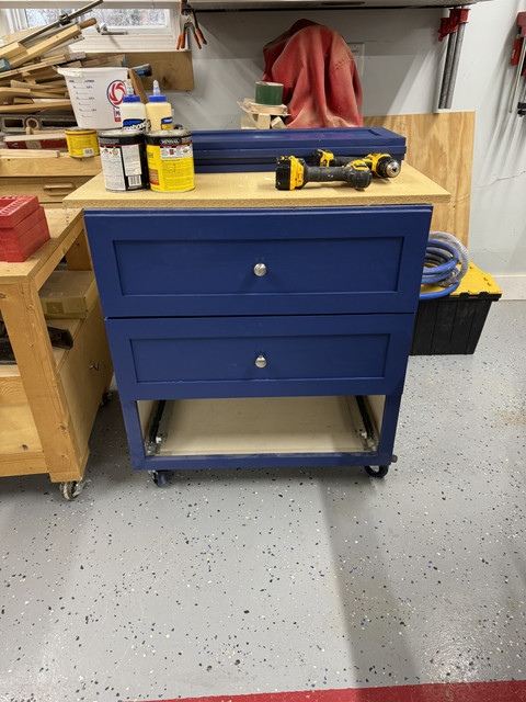

I have been working on building cabinets for my house.   I was going to make all the cabinets then do the foundational work.  I smartened up and did the foundational work first.  I just returned to making cabinets.  Here are my first attempts.  I have to figure out how to install the drawer fronts a little better.  Also the paint process is not as bad this time, I used the shellac first so not as much bleed though.  I will making the kitchen ones with maple instead of popular face frames.
I put these two on casters so I can use them to work on or move out of the way when not needed.  They will be installed in my garage when I am done with the kitchen.

I love the color. I'm curious how you did the drawers. Are those frame and panel drawer fronts, and how are they attached to the drawer sides?

I made drawers that fit flush with the face frame then made a shaker panel to fit over the front.  You can see in the background of the first picture the drawers.  The next picture is the overlay panels.  I used under drawer slides to mount the drawers to the cabinets.

Poplar is a great substrate but generally difficult to finish to look good.  The wood's green and ultimately brown/yellow colors are so strong, they are difficult to hide.  Excellent suggestion to use shellac to seal it up first.  These cabinets are striking.
