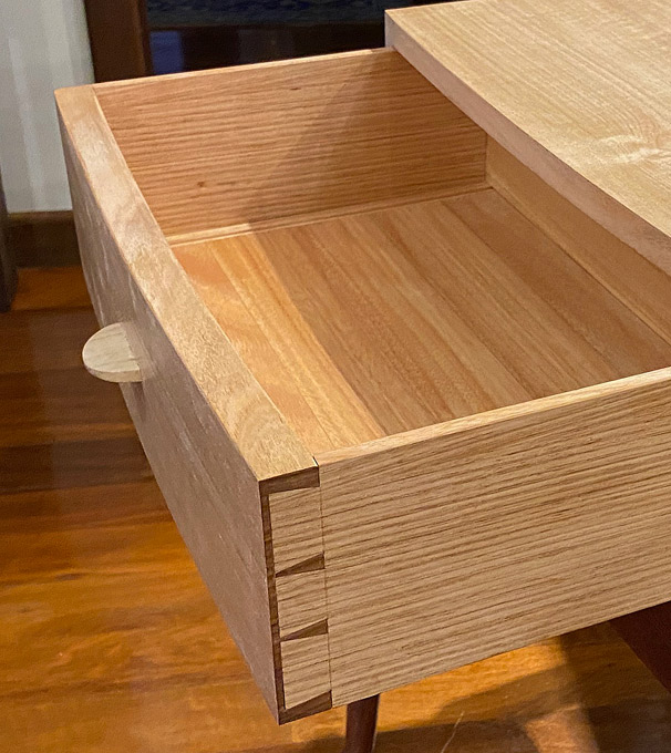

Henry, bow front drawers are really quite straight-forward when the sides are the same. Here is an example ...
https://www.inthewoodshop.com/Furniture/PowerHandTogether5.html
https://www.inthewoodshop.com/Furniture/PowerHandTogether6.html
https://www.inthewoodshop.com/Furniture/PowerHandTogether7.html
606x680

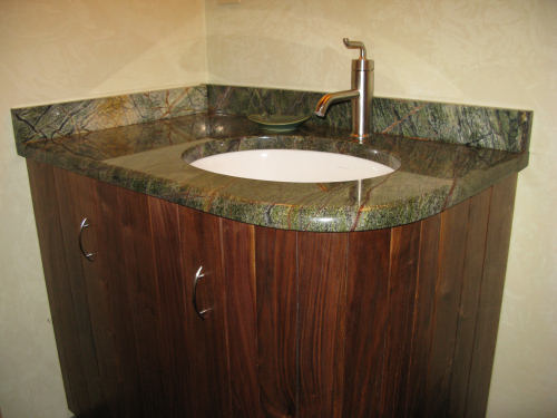

PS, here are a few shots of other vanities I've built using the stave technique. This first one is made of walnut. The door on the right has a two-high lazy susan shelf unit attached, so it swings open with the door. The curve follows the arc of the closing door of the bathroom with enough clearance to keep from pinching fingers.

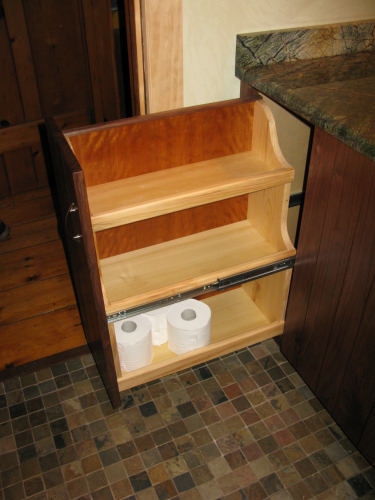

This one is a little vanity for a tiny powder room. The pull-out drawer is actually a three-high shelf unit. This gives full access to a deep, dead space.

@Ellis - hmm, hadn't even considered staved construction - so wow, that's a new one (to me).  As a solid wood panel did you ever have difficulties with a staved  inset door, or were these all overlay doors?  The overall lines of your last picture - the Narra piece - are what I was generally considering:  a long smooth curve across the face.
Henry
Re: Bow front vanity? Resources for build?
@Henry (Raleigh NC),
The doors on these cabinets were all overlay doors (or half-overlay, in the case of the unit I'm building now). They all have solid wood battens screwed to the back of the door to hold the staves in the correct alignment and precise overall width. It's not the finest woodworking, but it is a reasonable solution to the basic design problems of a vanity.
