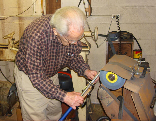

Jerry Glaser is one of my woodturning heroes, as is also Roy Child from the UK. Jerry's major contribution was HSS gouges ground from round stock + his jig for sharpening his V fluted gouges. Roy's contribution was the parabolic flute.
Here is an image of Jerry using his gouge sharpening jig...
