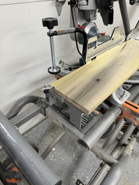

Well my old Kolbalt sliding compound miter saw just wasn't making it.  I tried to adjust it several times, I would get 90 degrees dead on, but the 45 degrees were off.  I decided I would upgrade and bought the Bosch 12" compound miter saw.  I liked the idea it could sit just about against the wall.

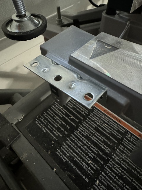

Now on to the upgrades.  My old Kolbalt had little flat pieces that I could raise up to make a stop.  The Bosch this is an upgrade and cost about $10.00 per side.  I had also made a zero clearance insert for the Kolbalt, so the Bosch needed one also.
I bought two bolts four flat washers and two locking washers total cost .60 cents.  I then bought a package of corner bracing for ~$5.00.  I had to drill out one hole on each brace for the bolts to fit though.  The bolts are 6mm x 30mm.

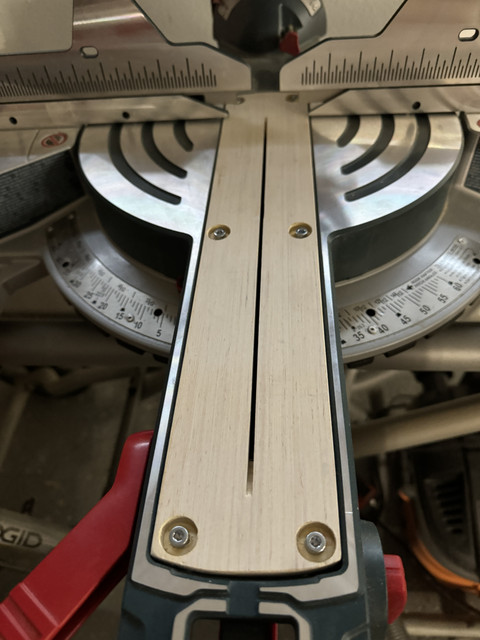

I had a scrape piece of 1/2 inch ply sitting around to make the zero clearance insert from.  For a total cost of ~$6.00 I now have two stops and a ZC insert.

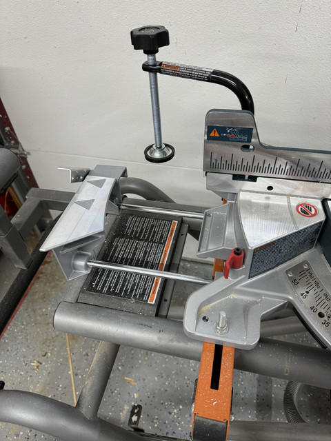

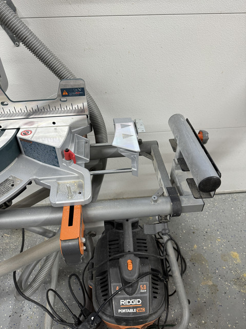

Here are a few more shots.  If I have to cut the same length over and over again, like the side of a drawer for multiple drawers.  I will take my time and measure from the side of tooth on the blade out and put a stop.  On most newer sliding miter saws they have wings that slide out to support the board.  I use these to place a stop on so I can make sure each board is the exact same length.  I placed a board on the saw so you can see how I use it.  I can use either stop on the right of the blade or the left depending on what I am cutting.  IMG-6028.jpg

Ahhh I see now.  Both the first and second pictures clued me in, last 2 helped as well. Thanks.
These are attached to the 'sliding' support arms of the MS.  Right?  I previously thought they were attached to the 'back fence'.
So are they limited to usage for pieces of a specific length range?
         - Shortest is from the blade to the edge of the table.
         - Longest from the blade to the end of the support fully extended.
Yes to both of these.  My mobile stand has stops built into also, so I can got out to around 5 feet.
