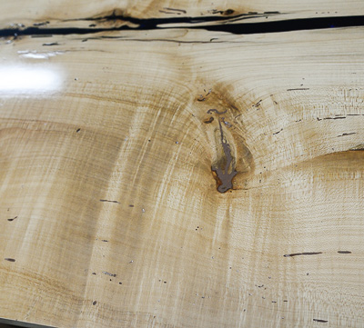

Set up 3 horses  where they'll get full sun all day.  Drape with VIZqueen (no black).  Spray the wood and stack it with stickers across the supports, then wrap with the film and tape the seams to seal.  Forget it for 3 months (got to 138*), then inspect for the amount of dead bugs.  Did this with infested maple
Wood's fine and usable.
